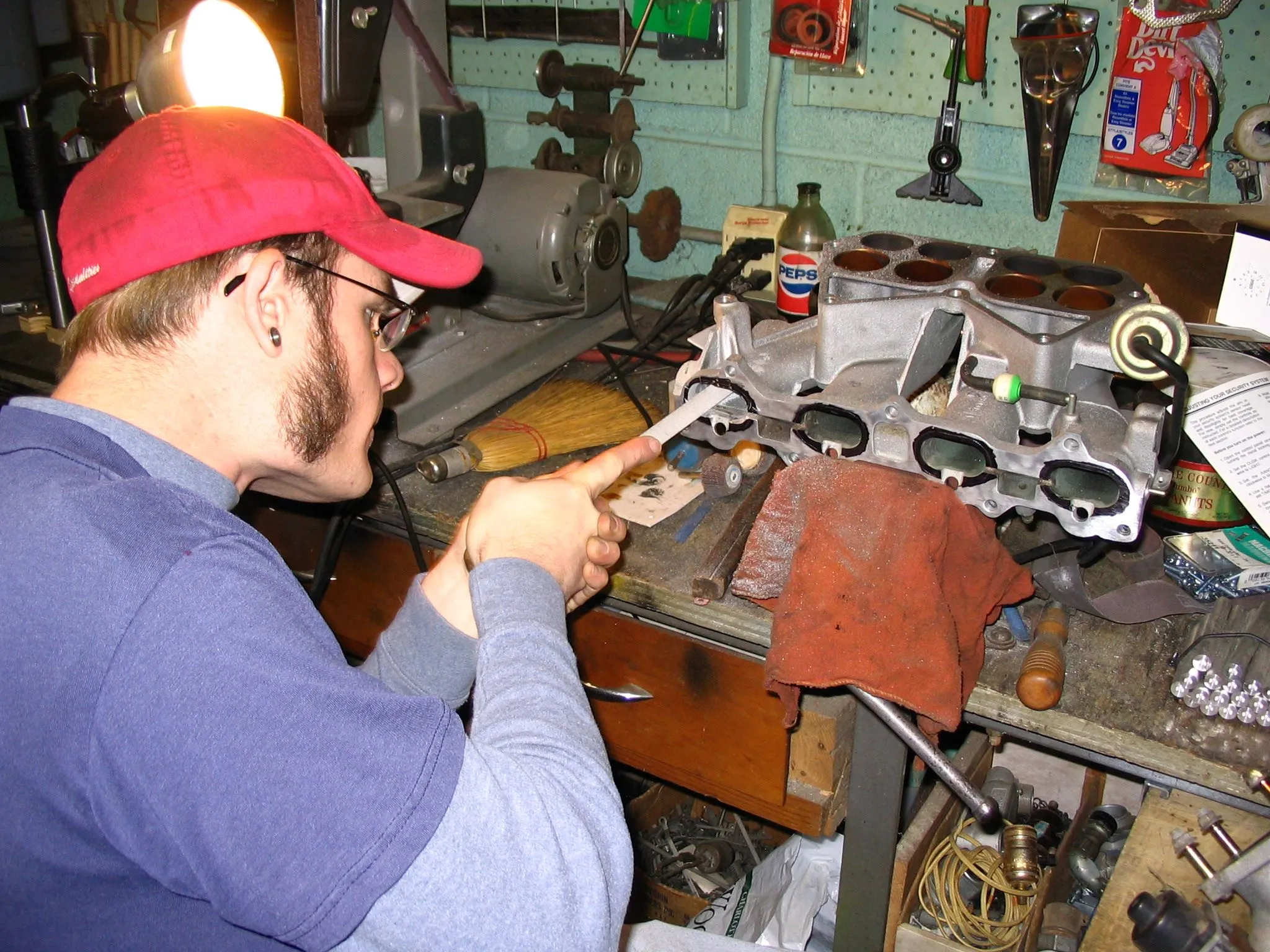

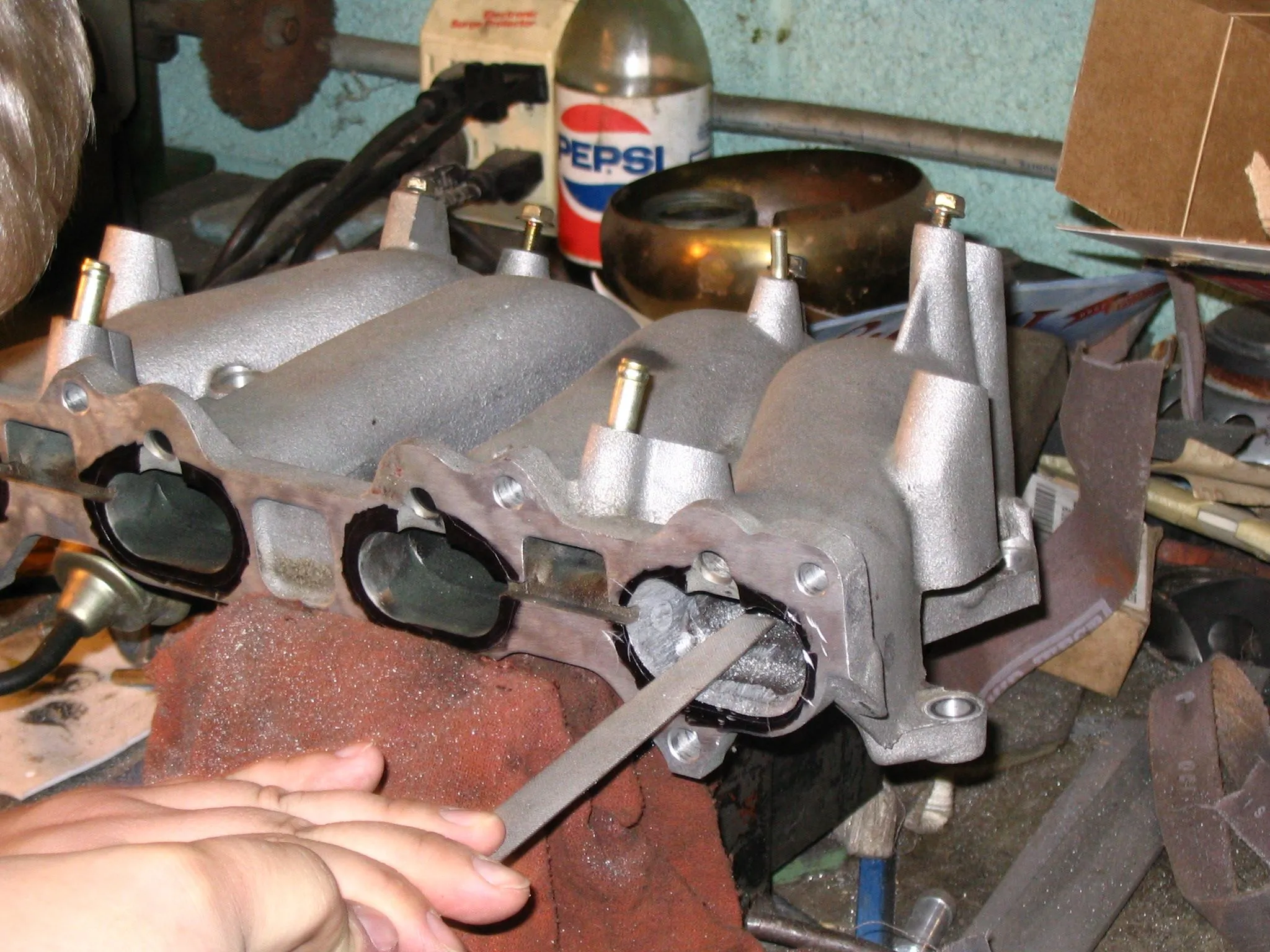

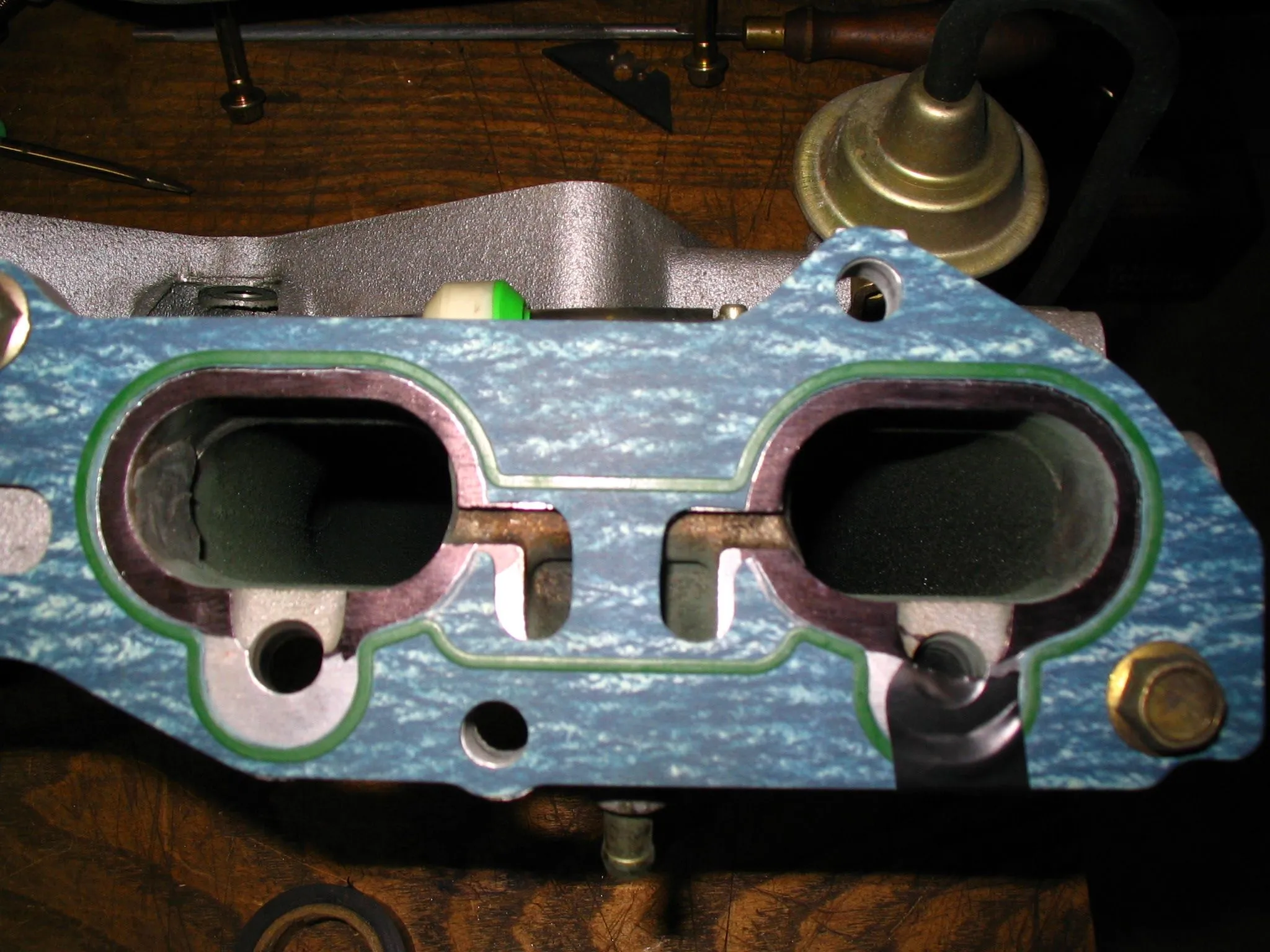

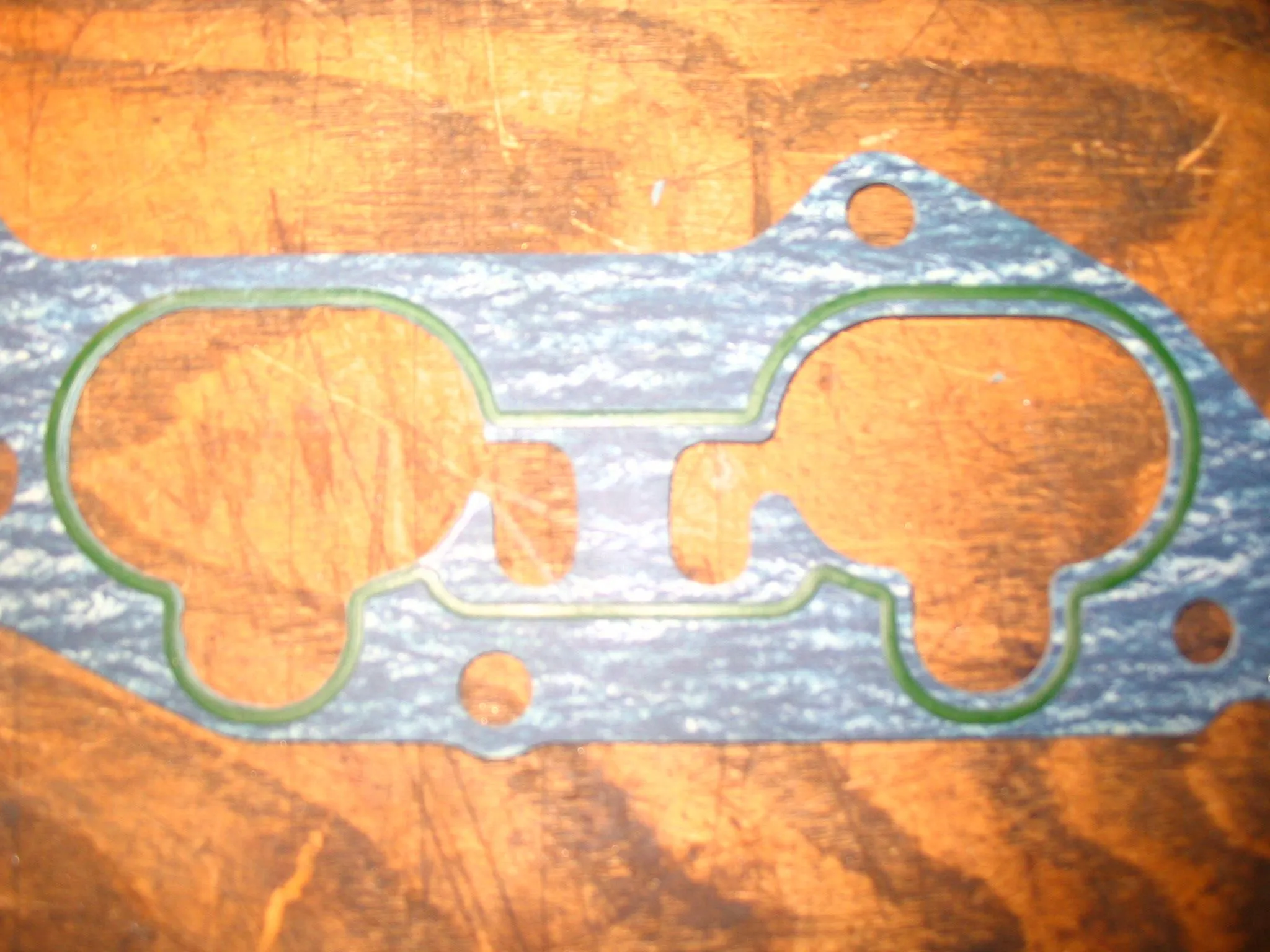

I finally got motivated to work on the Pro5. I'm moving up to Street Prepared for next season so I get to do some more modifications. I figured porting the head and intake manifold would be easy and quick since I had a spare one hanging around. This is my ongoing photo journal of the work.
The first picture is the stock intake gasket. The second picture is my enlarging of the intake openings. There is quite a bit of gasket there that is not needed. The third pic is the newly "ported" gasket on the stock intake. You can see just how much material will be removed. I used a magic marker to blacken the manifold around the openings so I could scribe the new larger opening.
The other pic is of me slaving away... which is not important right now.
I'll hopefully be able to finish the manifold tomorrow afternoon and start on the head after I get it off the motor.

Not to a mirror shine. I'll smooth them back down to the stock texture with my dremel when I'm done. The head might get a little tricky since, per the rules I can port match it, but I can only modify the first inch from the gasket surface. That doesn't leave me much room to compensate for the amount of metal being removed.

Lovely. =) I've done this to a bunch of manifolds now, and it looks like you're doing pretty well! The areas around the injector bung, where it sticks out into the flow, you're going to probably want to smooth that out and round the pointier edges of the manifold to keep the flow nice and smooth around the injector. =)
