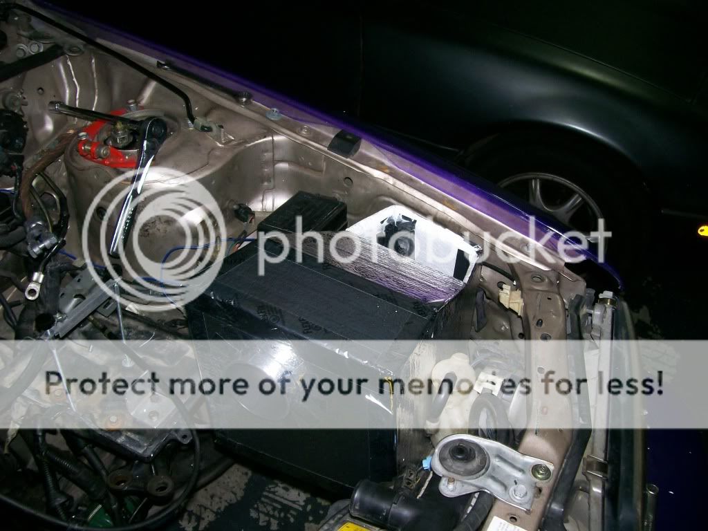

Here is the airbox I built.

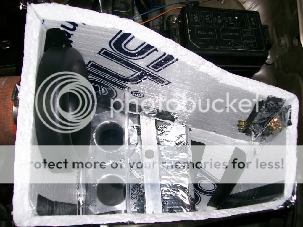

This is the inside of the box. The two ports at the bottom are for cold air ducting from the front of the car.

Is that a blox velocity stack?
What happened to the engine?
Yep. It's a pretty neat piece, but a little heavier than expected. I made the air box very lightweight so overall the whole intake setup should only be about half a pound heavier than the old cone filter setup.

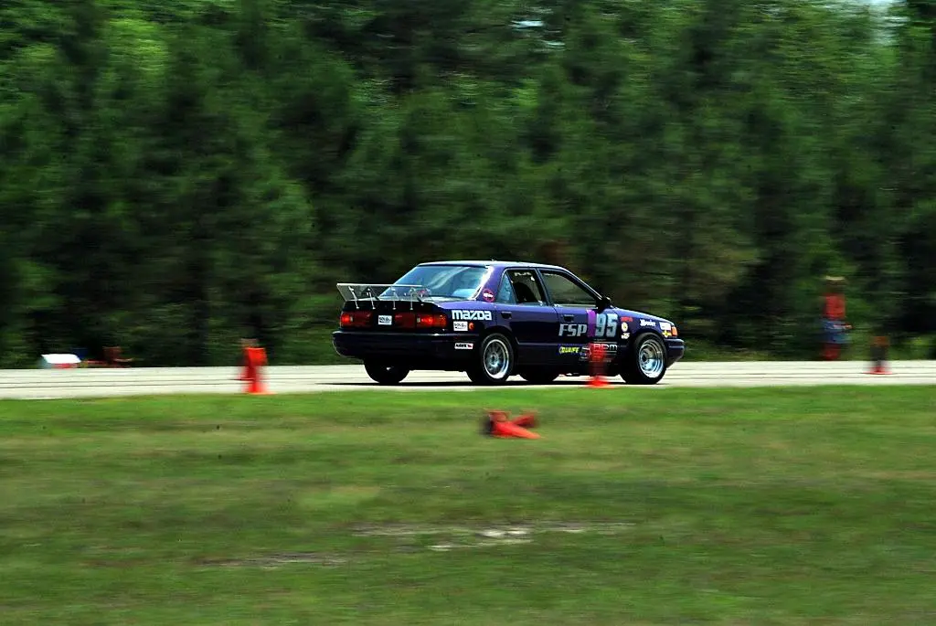

Congrats on the win @ Atlanta National Tour, beating the National champ and the codriver! Great job! How did you do it? I demand a story and what secret weapon did you put or did to yourself over the break?!
It was probably more course layout than anything. I beat Jinx and my girlfriend beat Ginette at a local event last year right after Nationals on a very fast course right before the old motor let go. The course in Atlanta was similar and really favored cars that were stable at higher speeds like mine. We hadn't changed anything with the car since Nationals other than dropping in a new motor and really working on the intake design. There were some areas of the course where the extra grunt of the Protege was able to shine over the Civic, especially on Day 2. I think Jinx is caught in a tough spot because he knows the Civic is faster on the 13" tires, but he can't keep them cool enough to make it through 6 runs.
As for how the actual event went I think I just had really great support from my co-driver and I really made the most of my course walks. Being the first event in almost 6 months for me I really concentrated on doing everything right from the moment we got to the event. We only made two mistakes with the car all weekend. We didn't cool the tires enough on Day 1 and it resulted in a slower third run for me. Luckily, my 2nd run was a really good one. On Day 2 I had a major fuel starve issue on my first run, but luckily it happened then and not on my 2nd or 3rd. It was the first event we had data on the car as well as video. My co-driver was able to really decipher the data and we learned a lot from the first day to the second. My 3rd run on day 2 was amazing and I got out of the car with my hands shaking. That rarely happens.
