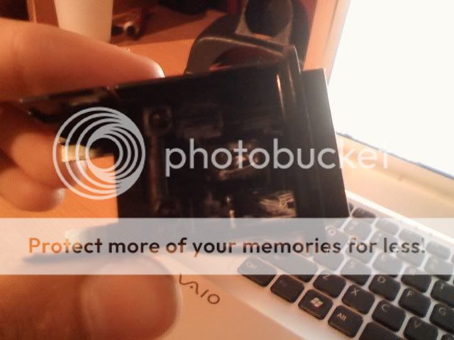

I like all this wiring talk.... :) If you got a switch from another Mazda that will fit in the slots like a fog light switch or a hazard switch that when you press it down it stays on you can do what I did to make it momentary (only on when you're pressing it down). I just took it apart and studied how it worked. I saw that it would grab a little notched area and that would cause it to stay on. I cut out the part where it grabbed and since it couldn't grab anything to stay on anymore it will only stay on while it's being pressed down.
And nice job on the swap Greg.
ya i figured out how to make the fog light switch be momentary, all you have to do is take a little piece out and if you ever wanted to be back to the way you started you can put it back in
That's exactly what I was thinking too. I figured there would just be a small tab that would hold the switch in, so it would close the circuit only when it's pushed all the way in. Remove that part, so the circuit to the starter is only closed when you hold the button in. When you let it go, it returns again.
I haven't seen the insides of the Protege fog switch but that sounds easy enough to do. The hazard switch I used I had to cut a part of the switch out.
little piece in middle comes out

sounds like your starter solenoid is bad then.
the solenoid is fine...he hooked up a ground wrong on the fusebox and it wasn't sending signal to the starter or alternator as a result...he just wants the push button start over the key now cause he liked my temp fix more after he drove it like that for a bit =P
(well, it was his godfather's idea, I just hooked it up that way cause I ran out of time to figure out why the starter wasn't firing over and it got his car running before I had to leave so I could make sure the mechanical side was a-okay before I left for norcal lol)
he just needs to hook the oem wiring harness starter connection back up to get the key working again
