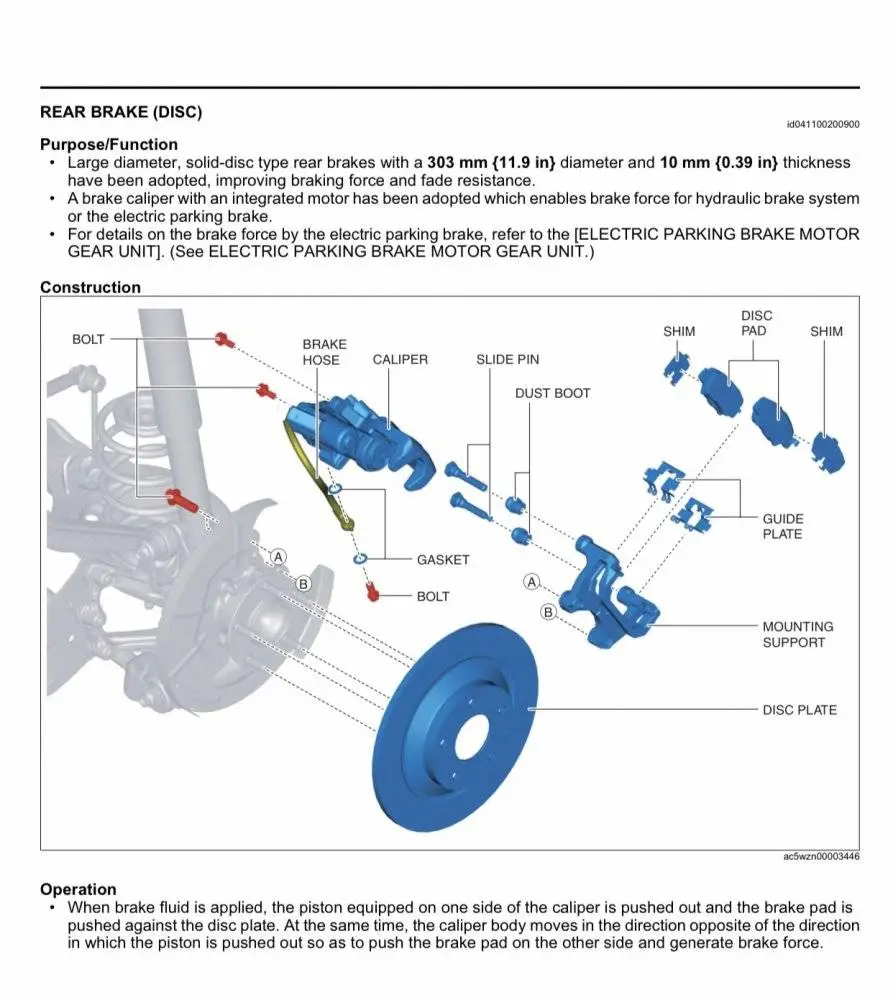

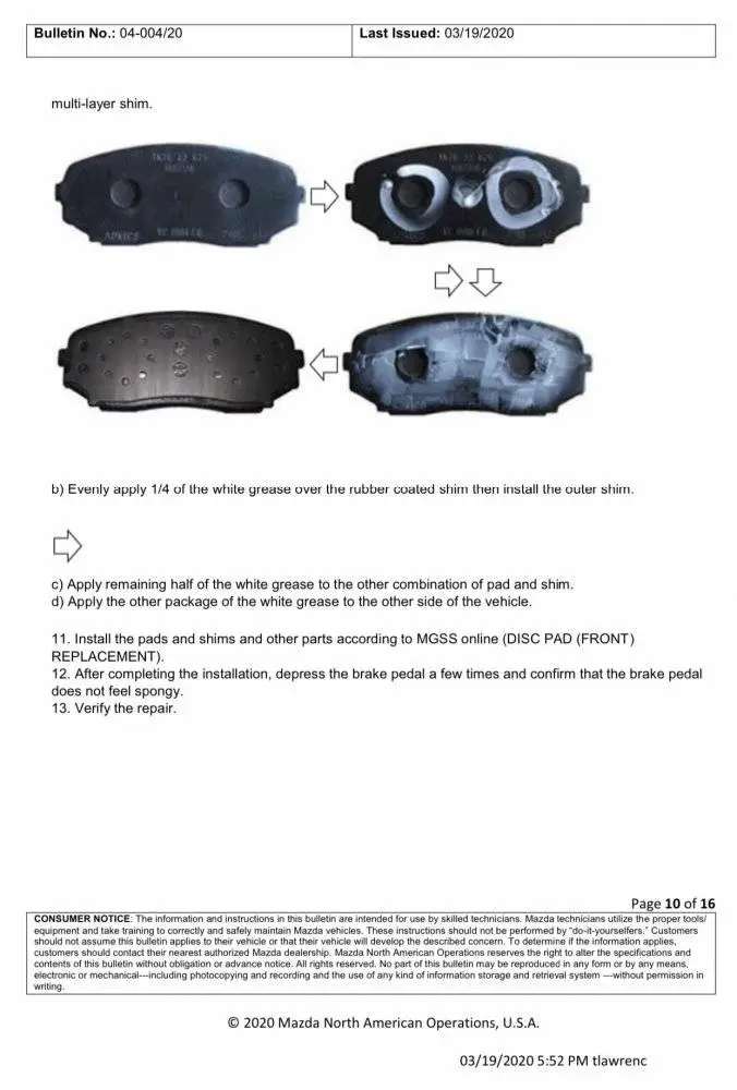

That’s weird. Here’re a couple of examples on rear brakes on Mazda CX-5 and dual-piston caliper front brakes on CX-9 (the same on CX-5 with 2.5T) and they all use single shim or dual shim on the back of EACH pad, inner and outer.
