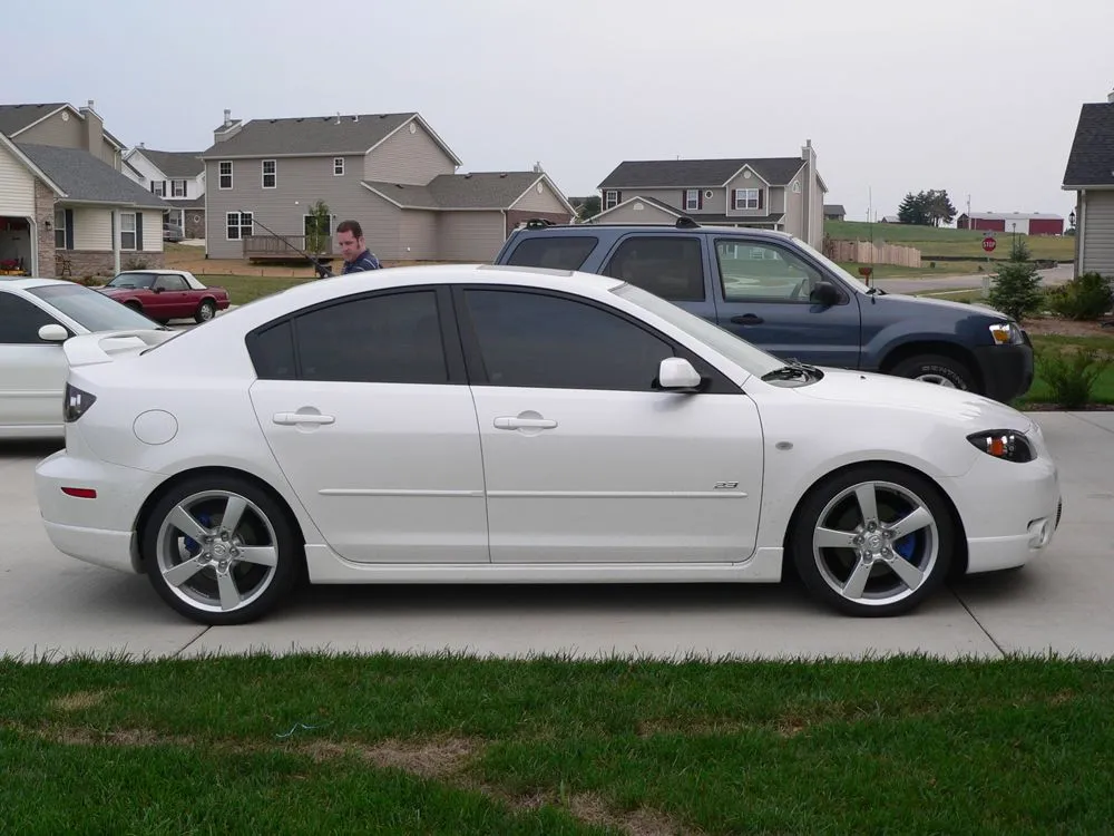

Here is a pic of mine. I have the Eibach Pro Springs on it with RX-8 wheels. I have 225/40/18 tires on them and the only problem with rubbing I have is when I am backing up and turning my wheels all the way. This only happens in one direction, I think it is when my wheels are turned all the way to the right ... so I don't do it.
I have them on my 2007 HB. No rubbing ever. I had it lowered on Eibach pro kit with Toyo FZ4 225/40/18 tires. I didnt have issues at full turn or with my family in my car. Fine now too. A 45 series may fit on stock suspension, but I am not 100% sure. Different tires will yield different results as well.
