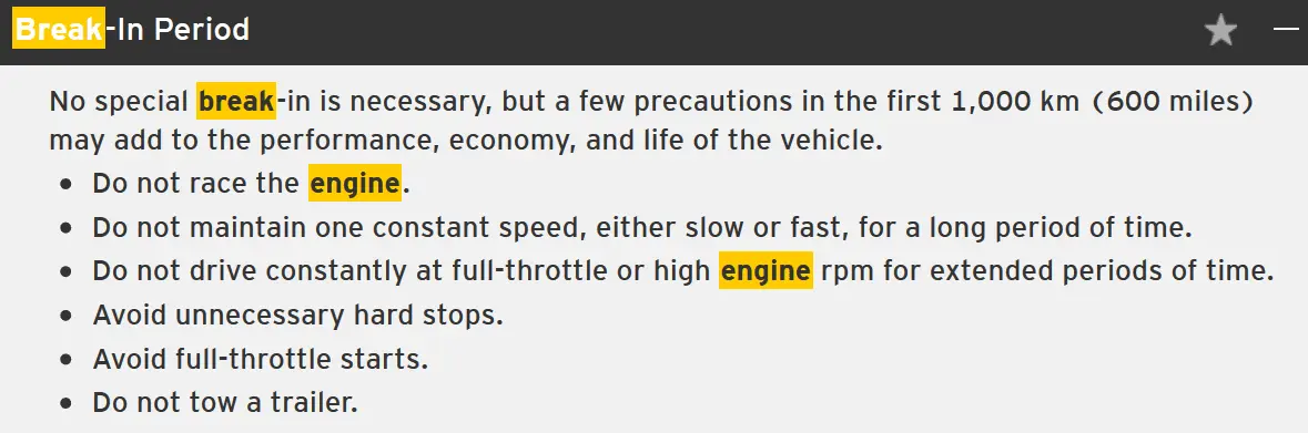

I have read that in general (not specific to Mazdas), revving up to 4k is fine in the first 500-1000 miles. However, Mazda states the following regarding their vehicles:
"No special break-in is necessary, but a few precautions in the first 1,000 km (600 miles) may add to the performance, economy, and life of the vehicle.
  • Do not race the engine.
  • Do not maintain one constant speed, either slow or fast, for a long period of time.
  • Do not drive constantly at full-throttle or high engine rpm for extended periods of time.
  • Avoid unnecessary hard stops.
  • Avoid full-throttle starts."
Now, regarding those points, the only one that we really need to worry about with regards to test drives is the last point - full-throttle starts. Very, very, very few people are racing the CX-5, or driving it at high rpms for extended periods during the test drive.
Breaking in an engine helps to ensure that early engine wear is kept to a minimum, and that the oil flows smoothly and evenly. It also gives the piston rings time to seat properly. In short, considering the type of vehicle we're talking about, I don't think an improper break-in is something to lose sleep over.
If we were talking about a genuine sports car, that would be a different story - those cars are meant to be pushed to their limits, and test drivers will likely push those limits during the drive much more often than someone test driving a CX-5.
With all that said, @Luke Thomas, if a proper break-in is important enough to you, you'd be better off looking for a brand new model with single-digit mileage. It will cost more, but at least you'll be satisfied. Just keep in mind that even those cars can be driven hard by those who drive them off the boat and into the port.
