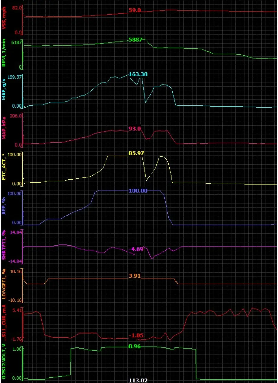

As I use Forscan to collect data, and happen to have a loaner '19 Mazda 3, 2.5L NA to compare it to, the issue is either the MAF is under-reporting, or there something else triggering the Miller cycle mode, which greatly reduces power until the PCM corrects. In my case the CX-5 takes 3 to 4 seconds before the PCM corrects. The low power condition is accompanied by a hollow waaah sound, which is caused, as I understand it, by the greatly advanced (early) intake valve timing.
The issue seems related to a generally lean running condition, most apparent when comparing WOT (Wide Open Throttle) readings. For everyone's reference, here's what the 2.5NA is supposed to do, under WOT from a rolling start.:
Most lines a re self-explanatory. The ones that may not be:
ECT-ACT = actual throttle plate opening, in degrees
APP = accelerator pedal apply in %
SHRTFT1 = short term fuel trim in % above/below desired. pos % = detecting lean increasing fuel. neg % = detecting rich, decreasing fuel
LONGFT1 = long term fuel trim %. pos % = detecting lean increasing fuel. neg % = detecting rich, decreasing fuel
S11_Cur = Bank 1 Sensor 1 upstream (before cat) A/F sensor current output. neg mA = rich, pos mA = lean
O2S12 = Bank 1 Sensor 2 downstream (aftercat) voltage output. 1v= rich, 0v = lean
I just heard back from the dealer, who basically admitted that while they could sometimes duplicate the issue, it did not set a code, and it's too difficult for them to get reimbursed by Mazda unless it's a demonstrably failed part or a PID code. So they punted. At least I had their correctly running Mazda 3 to gather known good data from. That's a win.

I tested that. When it decides to bog--more likely when it's 90F or more and the A/C is on-- stabbing the throttle to the floor doesn't suddenly wake it up when doing that u-turn thing, even though it does shift from 3rd to 2nd (but not 1st). Still takes 2 to 3 count to recover power. I can watch fuel trims ramp up over that time as the PCM sorts it out what *appears* to be under-reporting from the MAF for that load condition.
Although it could be several things, I am suspecting a somewhat drifted out of calibration MAF. My WOT maxes at about 139 g/s at 6000 RPM, whereas the Mazda 3 I drove maxes at 164 ~ 169 g/s at 6000 RPM. That's about 17% to 20% difference, which is not insignificant. For these higher compression Skyactiv I would expect the WOT g/s to be .85 to .90 x rated horsepower, or about 169 g/s, which is about what the Mazda 3 produced.
Don't suppose anyone else out there has WOT data for their 2014 or later CX-5?
