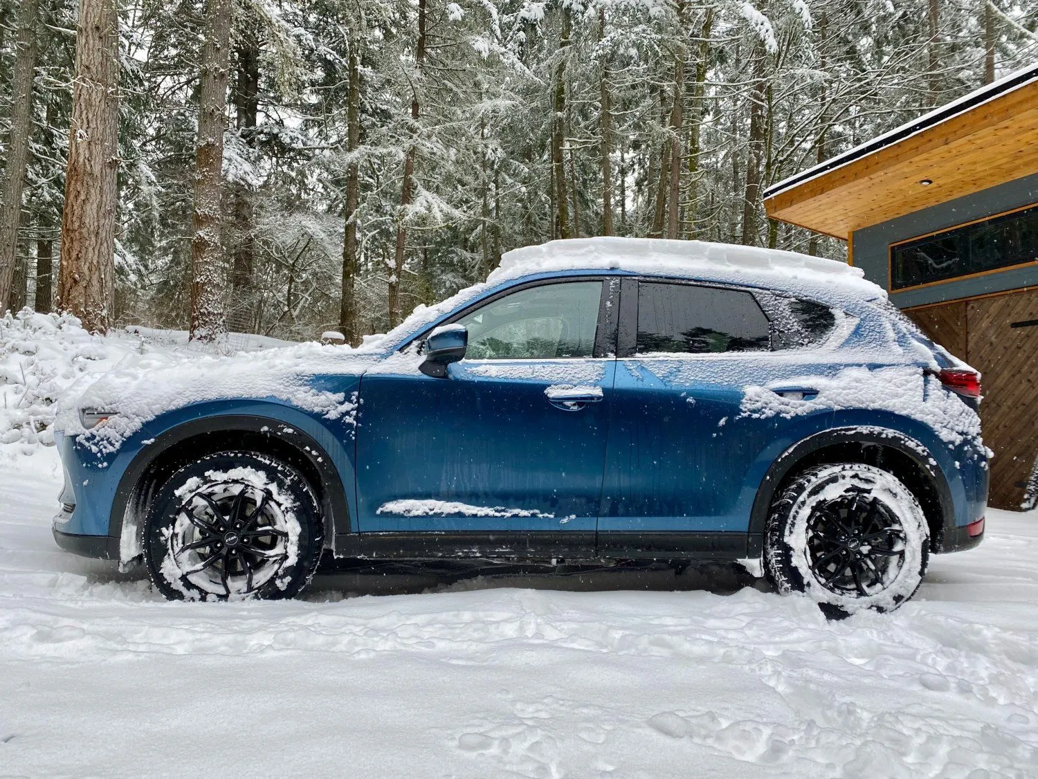

I ended up getting Rial Lucca 17" wheels with Michelin X-Ice SUV tires. The wheels had the correct center bore, no centering rings were needed. Perfect timing, as I mounted them on the car it started snowing and now we have 8-10" of fluffy snow. I was able to easily navigate the unplowed roads around my house today.
