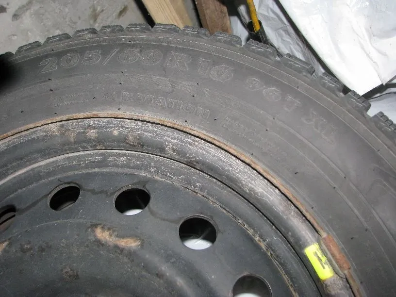

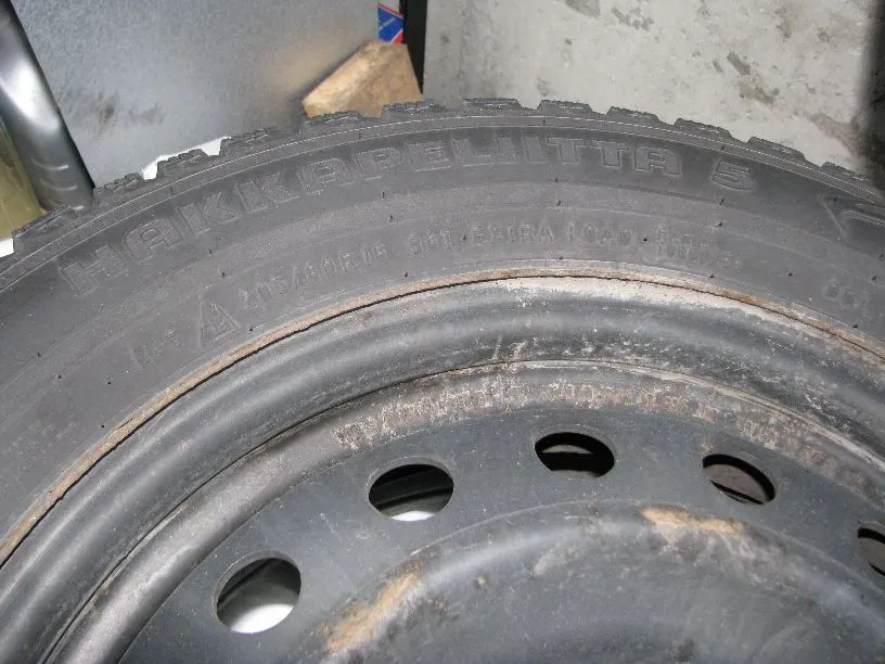

Hard winter here (Quebec, Canada), lot of snow, icing rain and all bull s*** you can imagine. I think that actually the low clearance does not allow any buildup. I was also afraid at first, also about rocks. But thinking of it I said to myself that with a 17" it will give about 1/2" clearance and allow a rock to stuck between. With about 1/16", it should not go between... Only thing I'm sure is that I have 6 months done without any problem.
Be sure to be able to try wheel, first model of wheel I tried did not fit!
thx for sharing. are you driving ms3?
so 205/60/R16 would be good. this is what I thought. lucky you get nakapelita ) very nice tires.. used to have nokians back to Europe.
Yes, MS3. Was not sure between 205/55 and 205/60. 60 profile is little higher in total diameter, but no rubbing problem for me.
My Hakka5 are studded, first experience with stud. Work really good, but more noise for sure!
