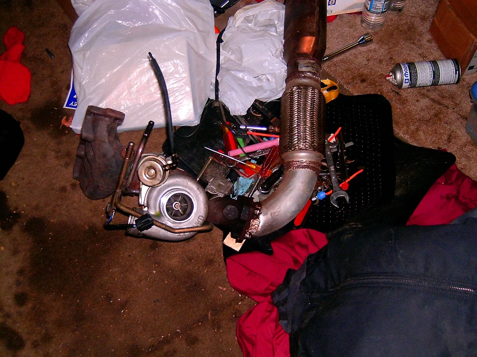

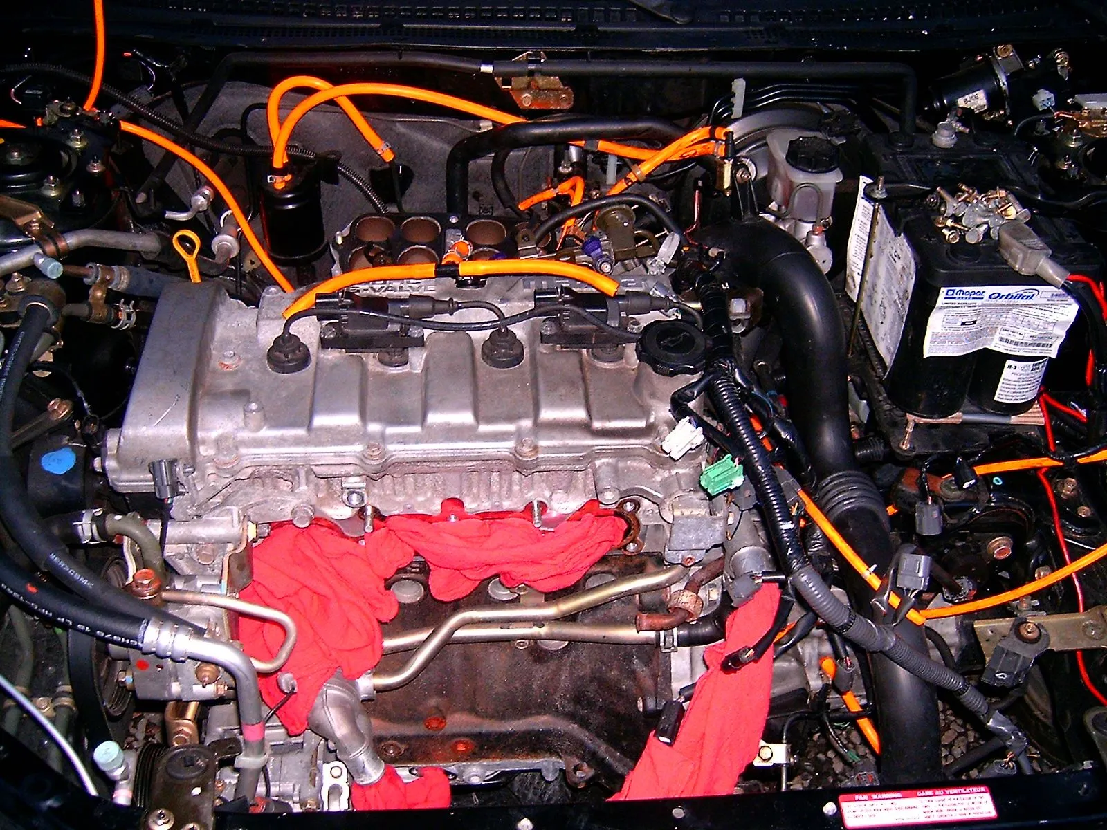

Just curious how many winter projects people have going. I tore the MSP down again today, gonna be porting out the exhaust manifold, s-pipe area. Also making the stock muffler flow with 3" inlet and pvc "muffler". I will be adding a cut out straight off of the s-pipe.
Also porting and flowing the head. May back cut the valves if my friend/engine builder things it will be benifical. Just making general overall improvements, not looking to make a race motor out of it. Porting another intake manifold to match up with the head.

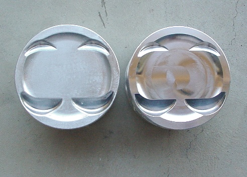

I will be building another short-block. Using more than likely cp pistons and oliver rods. I am going with 8.5:1 comp. and a longer rod set-up. I plan on playing a couple of tricks on the tops of the pistons ( have seen a couple of people perform this and had amazing results((almost 30whp)). Cleaning up the bottom end and oil holes to help oil control and drain back. The new bottom end assy. will be balanced.
I still haven't decided on the turbo. I may stick with the stock one for now. I will be putting a secondary fuel rail in before the throttlebody as soon as I figure out where to mount it so it can't be seen.
I am making my own intercooler that will be used for track use. I also may make hardpipes that I can put the stock ones over.
The goal- 12.5-7's on stock tires and street set-up. Low 12's with slicks and more boost.

and just what tricks are you talking about with the pistons?
Mine of course too... :) Yeah I"m curious on the piston tricks, but too late for me since mine will be here on Monday.
It's actually something done after you get them.
I'm assuming but curious if you are messing with the quench area and the dish shape to achieve greater mixing and thus the more horsepower? That's about the best I can think of as far as what you may be up to.

You basically got it right on the first one. If you think of the piston top as the floor of the combustion chamber it all makes more sense. The same rules apply as a porting of the cylinder head and changing of shape of the quench area of the cylinder head.

the piston on the left made 28 more hp. Anybody wanna guess why?
it appears to be totally smoothed.... no sharp edges equate to less chances of hot spots.... 28hp from increased timing?
Sort of looks like it has been swirl polished or roughed slightly... get you more turbulence during compression, gets you a better mix burns better/cleaner and with less hot spots... but I think Ryan also noted a good point too!
28hp from more efficent burn. No increase of anything. Exact same parameters between runs except the pistons.

I may just have to have my machinist clean up the edges and do soemthing similar to the piston itself! Very cool info.
yeah, my other guess is roughing to create quicker, more turbulent flow. but that other piston doesn't exactly look hyper polished.... hmmm

what car was that 28hp diff from? just curious what percantage it is, I mean it if it took a car from 150 - 178 thats amazing but if its from 500 to 528 ... well s*** thats still pretty amazing ;) lol
