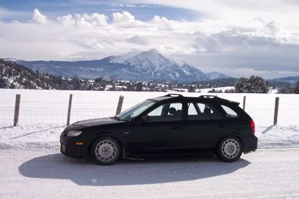

my winter set up!! 205-55-15 and old maxima wheels.. in carbondale co,.. but now im running 195-60-15 because they where alot cheaper and was short on cash this go round...BFG traction ta
Where in Louisville are you? I'm over just inside Jtown...don't see many Louisville P5s on this forum. Now that you've successfully tried it I may do 215s on my stockers as well...

No, just "all weather". When i bought the car the tires were toast and i wanted full tread for my wife. I run 17s now but I had to get two replaced so these went back on. Looks more stock, sits a little lower but they work for now. Not too bad for 4 new tires @ $80 total...
