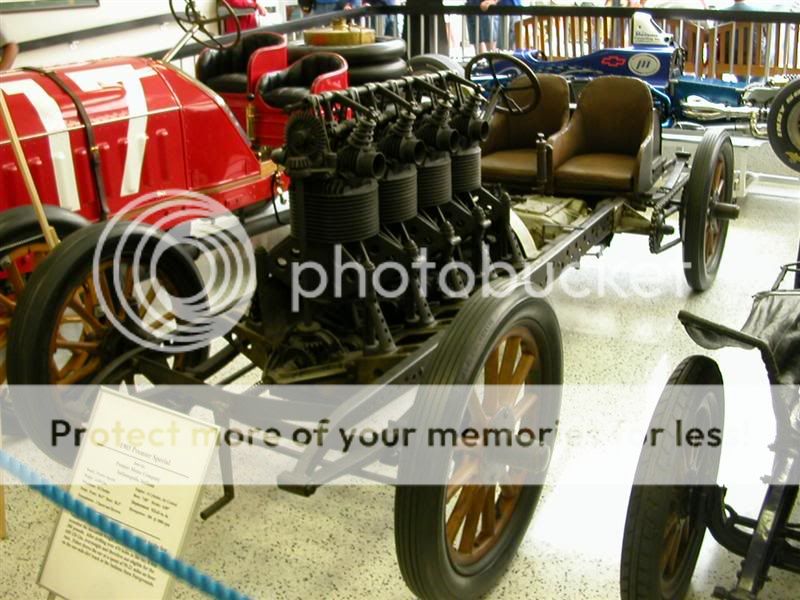

In the early 20th century, bigger engines existed, both in road cars and sports cars. Due to the absence of displacement limit regulations, manufacturers took increasing liberties with engine size. In order to achieve power over 100 hp, most engine builders simply increased displacement, which could sometimes achieve over 10.0 L. One of the biggest straight-4s of its time was De Dietrich 17,000 cc motor. Its cubic capacity is over twice the size of the Cadillac's 500 in3 8.2 L V8, which was considered the largest engine of its type in the 1970s. These engines ran at very low rpm, often less than 1,500 rpm maximum, and had a specific output of about 10 hp/L
here is a pic of another car big engine 15.4L
