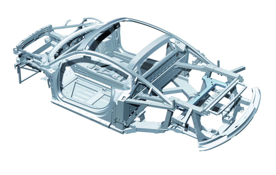

Crash worthiness is usually determined by the CRASH STRUCTURE. That is the spaceframe underneath the hood and fenders and everything else. Or did you forget usually the outside of the car is what the DESIGNERS come up with? Designers usually don't do much engineering, yes they may be restricted by the height of the bumper due to pedestrian safety measures and things such as that. But they don't determine crashworthiness. They make the shell. Its the engineers job to make the underneath crashworthy.
Thats the important part of an R8.
Thats where your crashworthiness comes from...they run the frame through FEA Stress Analysis long before any of the body parts...
