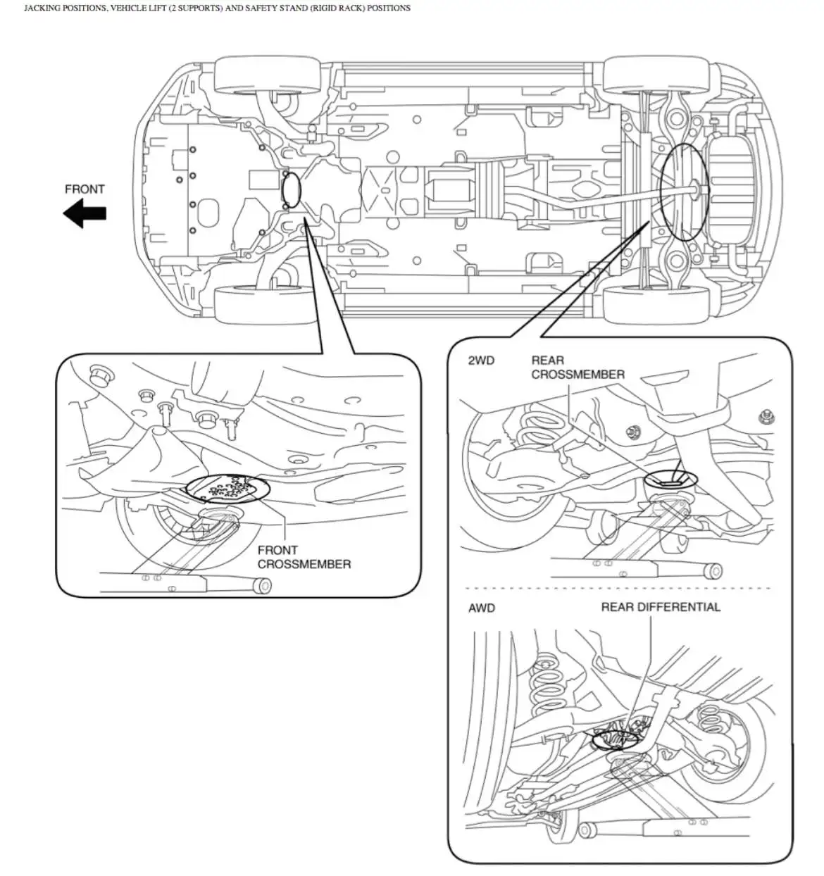

I thought about center jacking the rear - using 2 jackstands and going up front the same. ( I have 4 )
But the floorjack can damage the undercarriage if its not in a good spot and I cant find a good place even with a 2x4 - the rear diff wont not like it . These are not 1961 Pontiac Catalinas !
The front has a K member - but I cant be sure -- If damaged - not funny -
Mazda does suggest jack points - but looking for another way ..
Anyone have tried methods they might share without going in to a shop -?

So here's how I do a proper four wheel rotation (without using spare) in my garage. Let me preface this by saying I always use rubber cushions on the top of my jack stands and floor jack to prevent damage to pinch welds.
Start by positioning the floor jack about a foot further forward of the LR tire than you normally would to pick up that wheel. That way, when you lift the car, you should be able to get both left tires clear of the ground. Remove both wheels, remount what had been the LF on the rear and move what had been the LR to the RF of the car. Put a jack stand at the LF corner and lower the car while you move to the next step.
Move to the right side and jack up/remove the RF wheel. Move this wheel to the RR of the car and mount what had been the LR on the RF corner. Lower the RF corner and jack up/remove the RR wheel Install what had been the RF on that corner. Lower the RR and move the wheel that had been there to the LF corner and install. Use jack stands as needed for safety, but that's basically all there is to it.
These are the prescribed points and they’ve worked fine for me on the 2WD CX-5s I serviced. I’ll see what I think about the rear differential on the ‘23 AWD, but I don’t have any qualms following the manual.
Ok - im going to read the manual backwards like im reading Japanese ...maybe .....its there and i missed it - Thats likey the same on AWD- Many many thanks !

Well - I have a floor jack but its 1.5 ton ( 3000lbs ) so i suppose its ok just on the back end - the sequence is crucial- I also like conrads mania of cleaning and waxing each tire as you go -
- Thanks for the tip on DT - never know when that might come in handy - none near my home - The scissor jack is definitly not meant for industrial use and replacing them is $$$ - every salvage yard i hit ...i go straight to the japanese cars for the jacks / usually picked clean
- Thanks again for the diagrams !
I’ve been using those center jack points for years. Never an issue… I’m used to lifting my GX by the rear diff as well.
