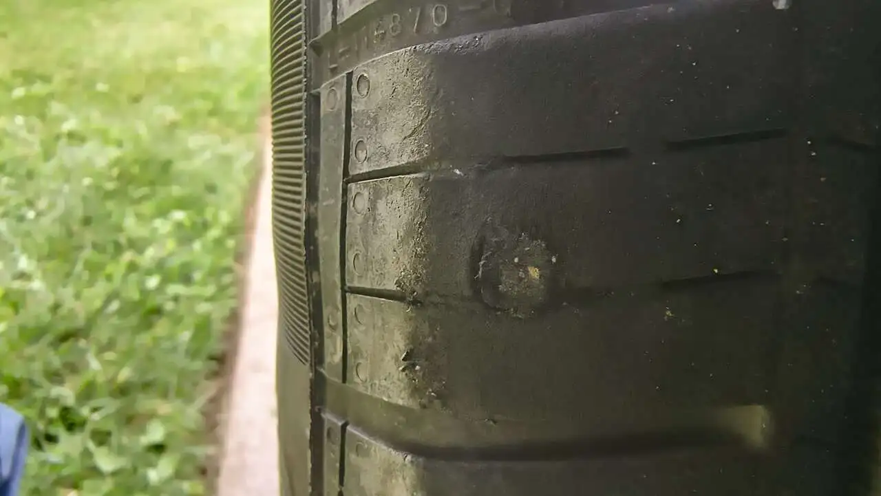

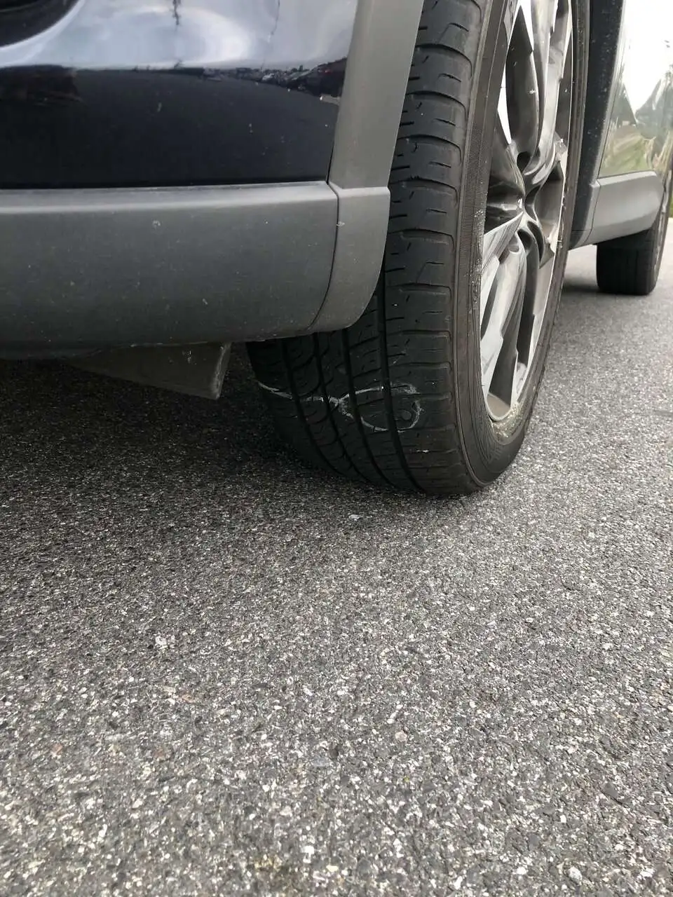

Tire had a slow leak. Took it to dealer as my trustworthy mechanic has recently closed and they said they couldn’t repair it - that the hole was too close to the edge. The tires I posted were the ones the dealer has is stock. Costco plugged tire for $11. I assume I will eventually need to replace.

If Costco says they can repair the tire, they will use approved method to repair the slow leak. They will dismount the tire and patch the leak from inside of the tire. The repair will last as long as the tire life, no need to worry about tire replacement anytime soon until the tread depth is approaching 3/32“.
BTW, your Mazda dealer could be lying about the leak is non-repairable just trying to sell you new tires.
Don’t go to car dealers for tire replacement or repair, just go to Costco since you do have one nearby. Or even better go to a local Discount Tire / America’s Tire and they usually will do free flat repair even if you didn’t buy the tire there.

The location of the plug doesn't look too close to the edge. In agreement with others here, I think "somebody" was trying to sell you a new tire and not very good one's at that. I've had tires plugged similarly in the past with no issues. I'd just drive it with no concerns. After a while you may not be able to see where it's plugged as it wears in.
It was a plug, not a patch.
Like @Jmaz said above, the nail location definitely is in the safe area to repair. Costco car service did a right thing for you.
For a proper tire repair, Costco and Discount Tire / America’s Tire use a mushroom cold repair plug patch like this:
The tech enlarges the nail hole a bit then pull the plug patch from inside and cut the extra plug even with the tread. Hence you see the plug part from outside. In the old days the approved repair was using a simple patch from inside. Later the plug part is added mainly to seal the nail hole and prevent the water getting into the tire plies mostly steel causing corrosion damage.

Based on my experience I do believe the nail location shown on the picture is repairable using the inside plug patch at the Discount Tire. As long as the nail is not truly at the “tread edge”, Discount Tire will fix it with approved method.
Former moderator @Chris_Top_Her used the plug to fix the nail hole from outside a few times and has never had any ill effects. Since Discount Tire usually will fix the leak from inside for me (and for free) all the time, I have never bothered to DIY using a plug. The worst example was wife got 3 nails at the left rear tire on the BMW 528i and DT fixed them with 3 mushroom plug patches next to one another without any issues. My feeling is the patch or mushroom plug patch will never come loose from inside with air pressure keeps pushing it, but a plug from outside “could” with constant air pressure pushing it outwards.
