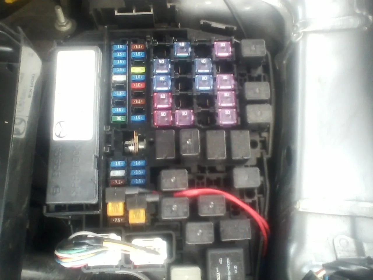

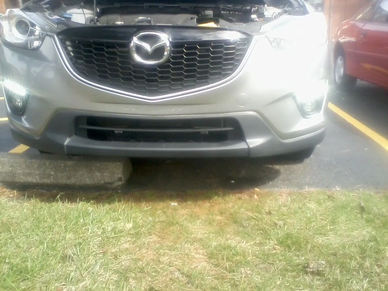

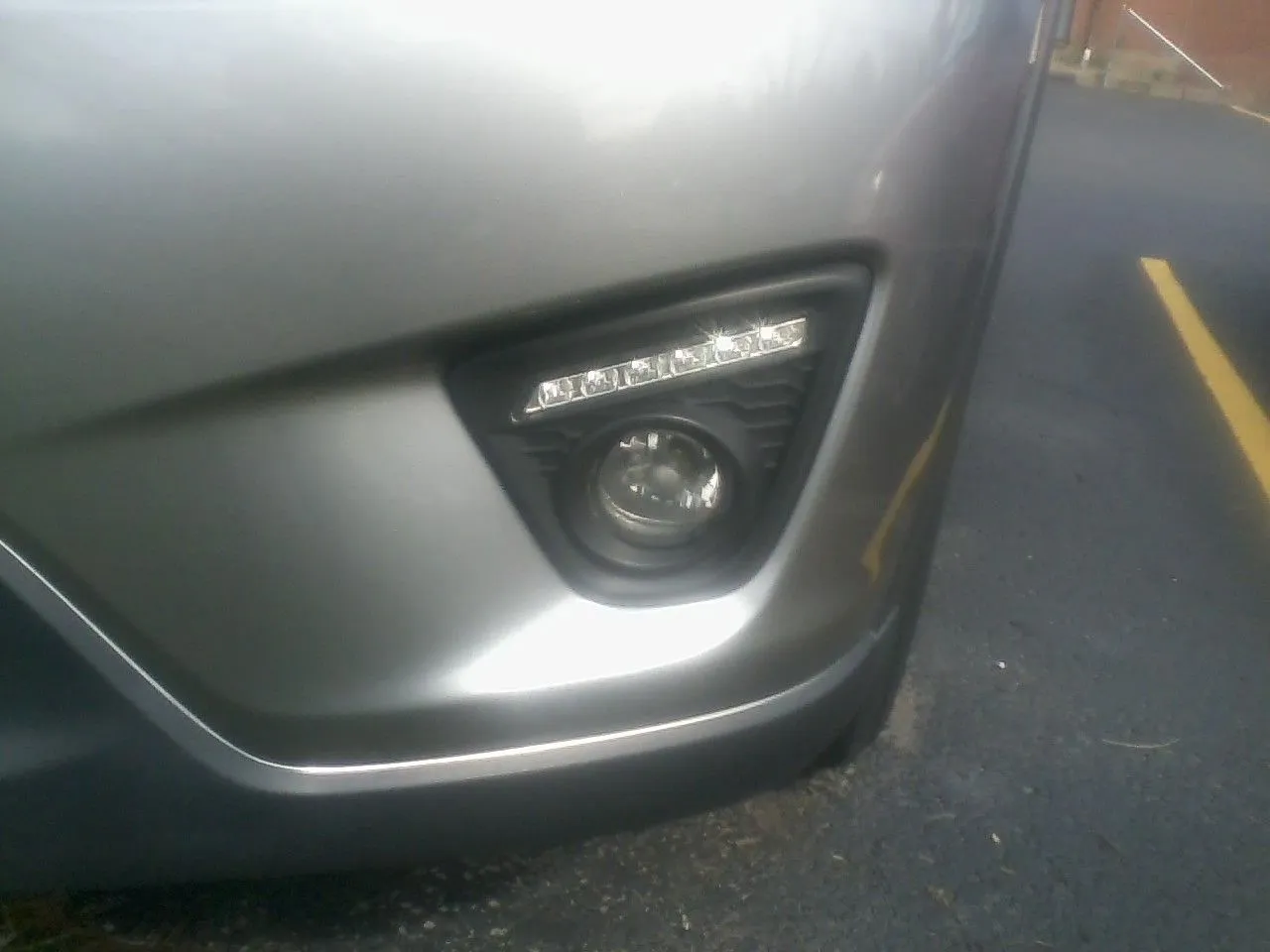

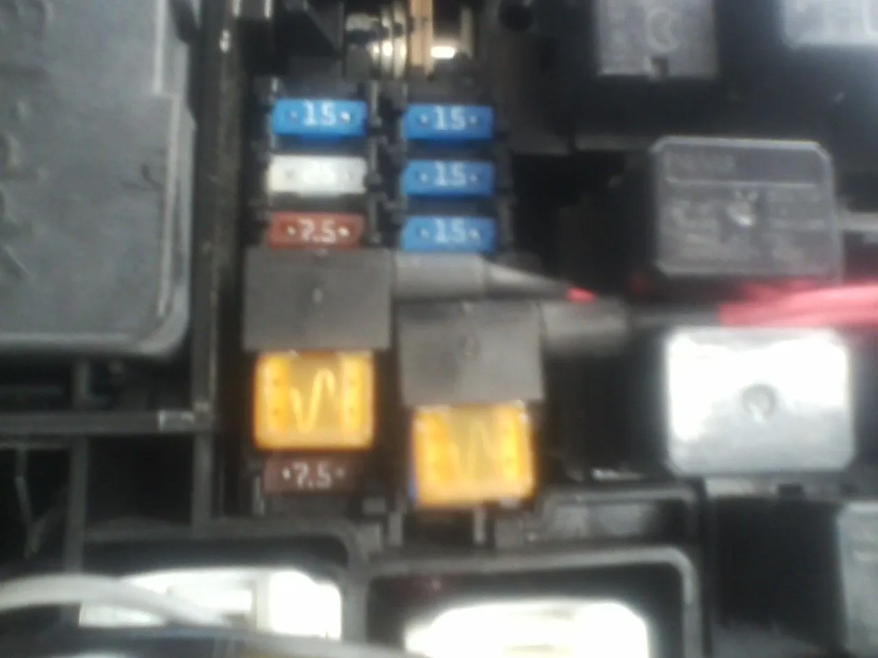

Lbear, it's almost 3 years since I installed my aftermarket LED "drl's" above the fog lights.I recall having difficulty getting them to work trying to tap into the drl fuse.What I did was (using the fuse box under the hood atop the drivers side fender) I used fuse taps and took power from the location marked "meter 1" which is 10 A and 4th from the bottom on the left hand column of fuses.(See inside of fuse panel lid for labeling).This powers your gauges/instrument panel so the leds come on when ignition is on and stay on until shutoff.
Also, tapped into fuse marked "H/L low etc." 15 A located 3rd from the bottom in the 2nd from left column of fuses.This is a control wire that dims the leds when the headlights are on.I tried to get the other control wire to make the led blink with my turn signals(yea what was I thinkin') but had no luck trying different things and just tied that wire up unused.
If I can figure out how to post a few pictures I will. *******NOTE********** the fuse taps have the appropriate fuse as mentioned (10& 15A respectively but also have a 5A fuse to protect the control box. I love them as being brighter than the stock drl's they give added visibility to other drivers since my liquid silver looks kinda grey and blends in with the road somewhat. Good luck. Jmaz
pics of Jmaz LED power taps and LED's
Pardon the crappy phone pics and the one with sunlight glare but you get the idea.There's better pics online.
Also note a notch cut in the side of the box for the red wires. Adios!

The LED DRL's referred to in my posts #6, 7 above are still working fine. The LED housings themselves are aluminum and are attached to the black plastic piece that replaces the original and may (IIRC) have fins on the backside for cooling. Relying on memory, the country of origin is Taiwan and I paid around $ 100 for them as a kit consisting of 2 light assemblies, control module and custom fit wiring harness. The custom harness was a blessing when it came to installation. The instructions were decent also. The fuse taps and extra fuses were purchased locally.
If they ever fail, they'll get replaced again. To me it's a safety feature because of the almost gray looking Liquid Silver color which blends into the road more and the rather dim stock halogen DRL's. Other cars notice my LED's and are less apt to pull out in front of me. Notice I said cars. Pickup trucks are another story. And pickup truck drivers (some anyway) around here are a story for another time.
