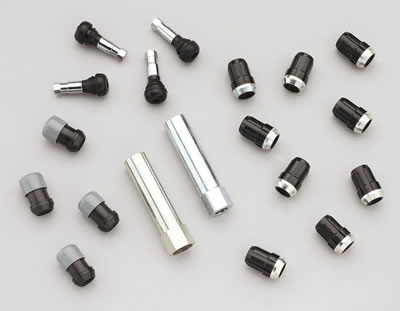

I found these on summitracing.com, they are McGard and the are 12*1.5....
i wanted black lug nuts ...would these be ok for my P5 on stock wheels..?
i'm assuming if the lug nuts are 12mm by 1.5 then they are ok for our cars right..?

I also found these lugnuts which are cheaper...
the website stated that the 12mm by 1.5 is perfect for our mazdas...
chicken, the ones you just posted are available in several colors in those sizes on ebay for 29.99 plus shipping. they have open ended and non open ended as well as acorn style and not. As mentioned above it may not be a good idea to use the acorn style on a stock wheel. Although I would think it is the threading between the lug nut and the bolt and how tight you make it that would be the main factor in keeping the wheels and lugs on.
