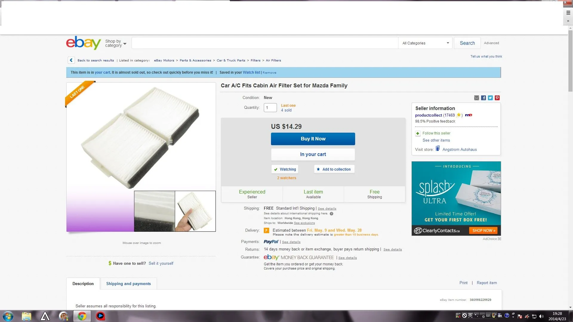

where do u buy cabin filter for MSP?
03 MSP OJ
i used to buy filter from a ebay guy , its 14 usd / 16 cad shipped from hongkong
they had 5 of them when i brought it last winter, and i just brought the very last one today XD
i sent a msg asking if theres more available.
just in case i cant get it from that seller, where do u guys get urs? and price?
i searched ebay and theres only few seller from UK selling it for roughly 45-80USD shipped to canada
maybe i should ask TheMan XD
attachment.php

yea i followed TheMan's DIY, made that cabin filter slot open and got the cabin filter cover from dealer.
and the eaby seller told me they will refill the stock, but date not specific. but its ok i got mine ordered, and wont buy another one till the winter time anyway XD
