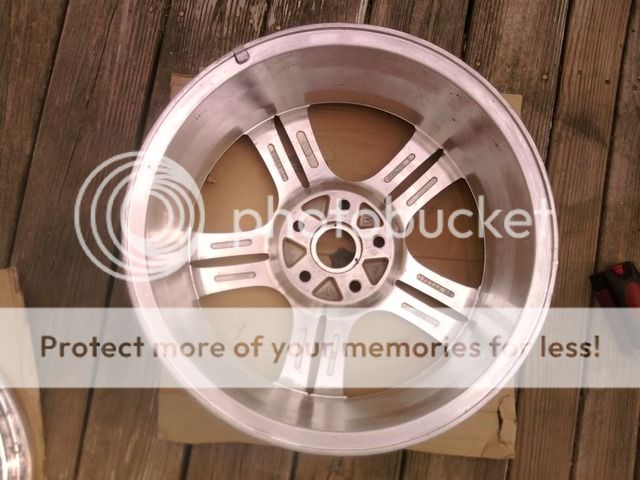

Here's the hub face of my Racingharts:
If that helps you as a reference. Just take some measurements of your wheels, the clearance in those pockets on the back of your wheels, the length of the studs, etc... And then add em all up to see how big of a spacer you need to run in order to clear the studs. With 15mm spacers, my studs barely clear. The studs actually left marks in those pockets from just barely touching the back of the pockets.

You need at least 20mm spacers to clear the OEM wheels, but some aftermarket wheels have deeper pockets, like in the above pic, to allow only 15mm spacers.
