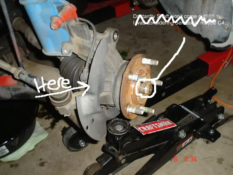

wheel bearings
this isnt my car but just a pic i found here on the boards. It kinda shows where im talking about with the arrow. i put some oil between that rubber boot thing and the hub itself. what ever is metal inside that rubber boot is what is rubbing on the hub behind that dust shield
The rubber boot is the drive shaft dude. you might of lost the clamp that holds the boot in place?? It is supose to be inserted into the hub, but if it was not you would know!
took it back to the shop. turns out i need a new right side axle. while the car was up on the lift, the mechanic was showing me the play that the axle had compared to the stiff left side axle. the right side was moving all around
the loose bearing ball spinning around noise is gone. will be getting an alignment this weekend and ill be able to see what noises are left besides the pad dragging.
