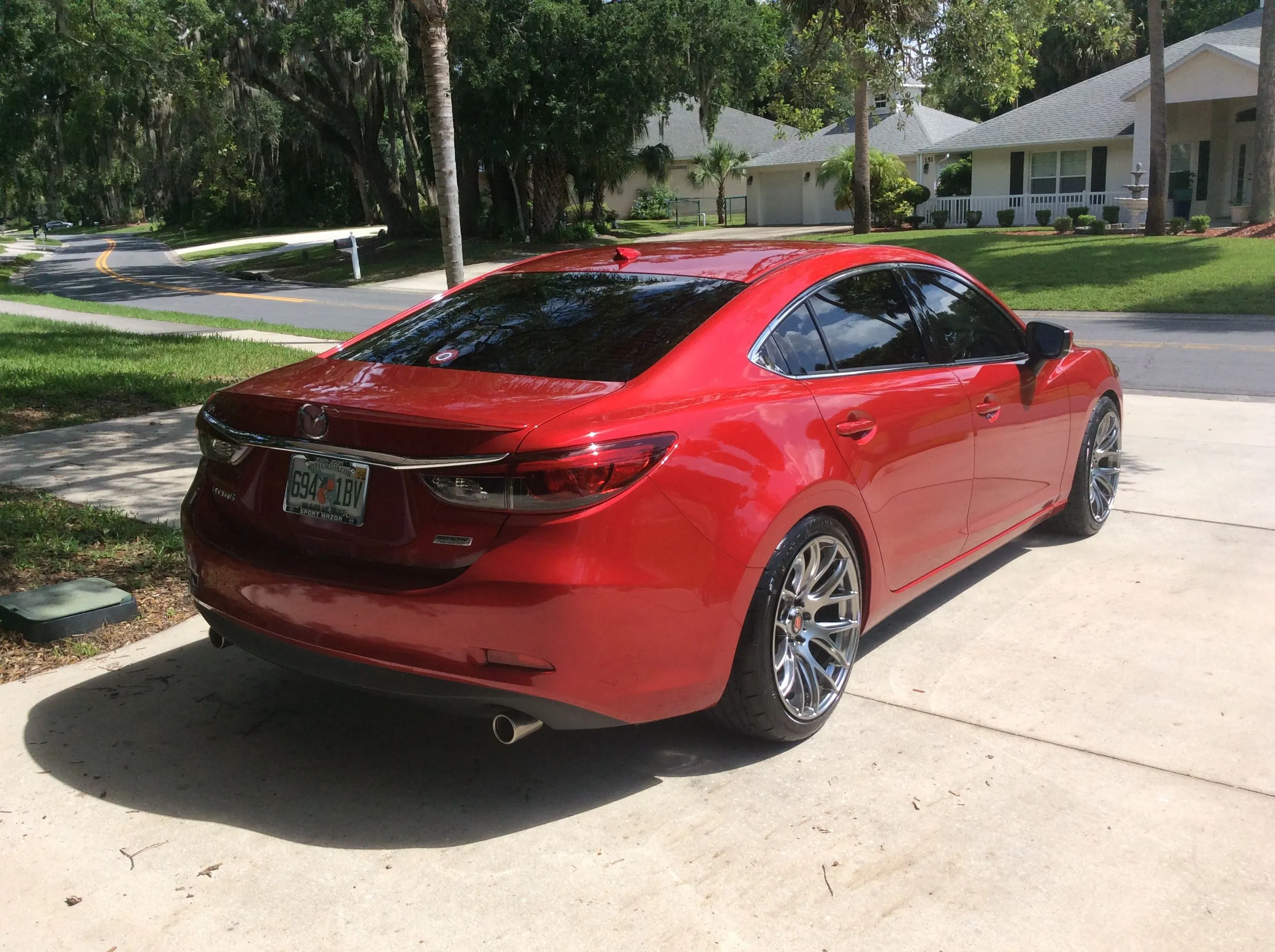

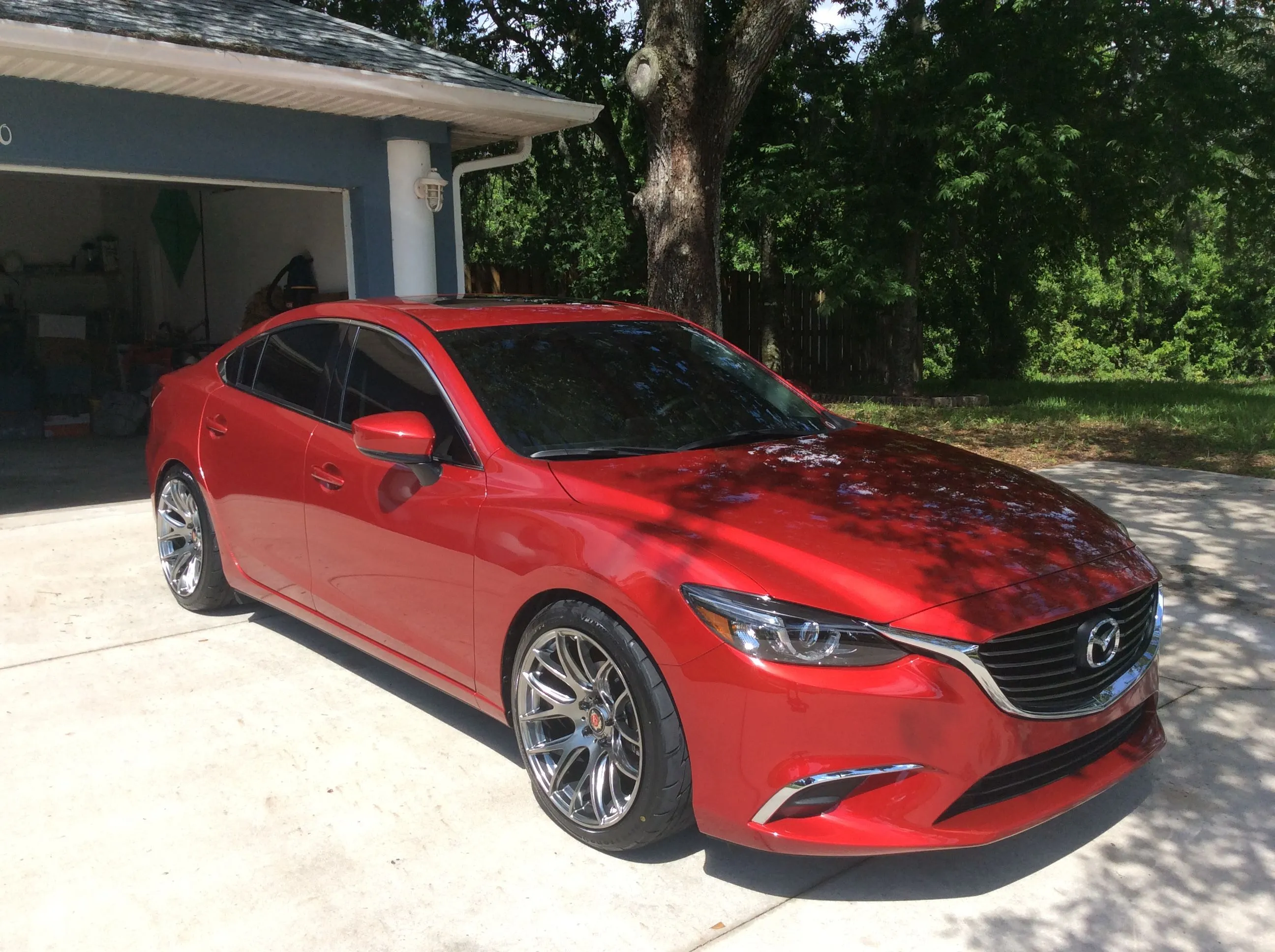

Well Gj it doesnt rub at all, even with H&R springs. It rides a tad bouncier but no much, my wife didnt even notice at all. Corners much better with the springs. Get compliments all the time on the car, people ask what it is and when I say its a mazda they are like "REALLY?? A MAZDA??!!"lol
Your car looks awesome. What are your wheel specs? Width? Offset?
Wheels are AXE CS lite in hyperblack 19x 9.5 with +40 offset on firestone indy 500 tires in 245/40/19. Thanks for the compliment!! I love it!
