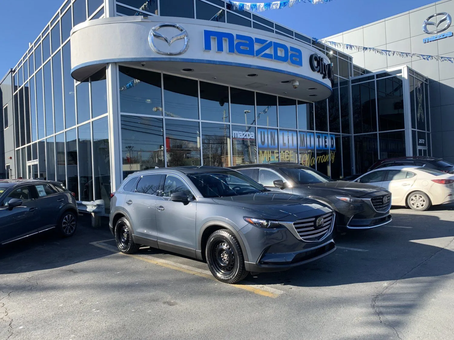

Same tires, same rims but in 18 in.
No real reason for 18, I asked dealer to build it into price and he went down 2 inches. I'd probably not like how it looks if side by side the 19 inches, but as is I've been happy.
Kind of a beefy tread look to the tire, which I like. Handles snow in Toronto fine, but we don't get a ton.
