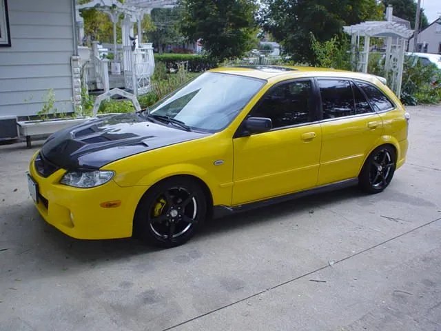

Krazie, got pics with the h-techs? And how much harsher was the ride over stock? Did you have to creep over speed bumps, or could you bomb them?

Attached is a pic of my P5 in its prime on Illuminas and H-Techs. Drop was subtle but plenty, as the stock wheel gap is terrible in my opinion. As for drive ability, it was a very street friendly setup. About the same as the stock MP3/MSP suspension feeling, but more responsive. You couldn't quite hammer through speed bumps, but you wouldn't feel every little bump in the road either. I liked it a lot.
