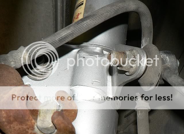

KYB and OEM struts have about the same thickness steel for the rear strut sway bar link tab, about .17" thick. I have no idea how you would break that, it must be crappy welds. The KYB had a very nice weld and the OEM wasn't very poor either.
First off, thank you so much for that, sephro! I really appreciate it.
I took my car to some ghetto muffler place today, and had him weld the tab back on there. The tab sheared in the middle, not at all at the weld, which is extremely odd. But the guy had the explanation: when my endlink broke, I bought hkpro's very nice home depot special endlinks (awesome, btw). I had to take my car somewhere to have them remove the endlink bolt from the strut tab, it was on so tight. So I didn't feel like messing with the other unbroken side. So I left one side oem, one side upgraded, which I sized to match the oem endlink. Well, apparently I should've put both new endlinks on, so as not to shear the tab. As hkpro's endlinks come, they are slightly too long, even at the shortest setting. This imbalance between oem and hkpro caused the tab to shear. This guy welded the tab in a slightly different location to accommodate the hkpro endlink on the right side, and I'm still oem on the left.
Ugly ass weld he did, but beefy with some nasty gusseting, looks sturdy. So I bought some time. But thanks to sephro's input, and the knowledge that the tab didn't just randomly fail, I'll probably be buying some gr2's in a few months.

The reason the attach link on one side and disconnect on the other would wear the tires is because the sway bark is still attached with the two chassis brackets and they have a weld metal edge to keep the bar from sliding left and right. This means when you go around a corner one strut can bend out slightly and the other stays still. Thus if broke on the rear driver strut, that wheel plus the diagonally opposite tire will wear badly.
