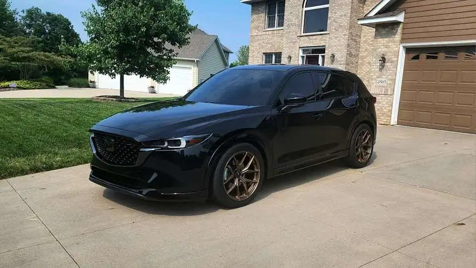

20x9.5 38 Enkie TSR-X
275/40r20 Nitto Invo.
Does not rub with Corksport coil springs. IT looks like it does, but it doesnt.
I very much doubt you could go any wider; Very aggressive fitment, and would clear any brake kit, including the Corksport BBK. You could probably do a 20x10 40, but thats a maybe; I can't even get my pinkie between my front tire and the strut.
