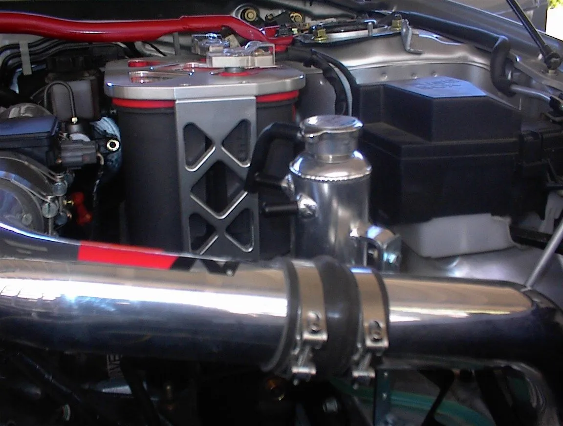

34/78 Red top with custom battery box. (Head over to ebay and type in "billet optima") The stock tie down will work with mild massaging with a hammer and a quick respray :)

Nos said:
nice , your header is jet hot coated ?
Yup. I've used them in the past and have always been happy with the results. However, unless you plan on holding on to your ride for a few years it's probably overkill. At least the battery box can come along for future projects.
Nos said:
how much is it to jet hot an OBX header ?
about $ 160, i know they were doing a 10% discount, not sure if they still are. They also have jet-hot 2000, suppose to be for a lil bit higher temp for about $20 more.
So if i can find a shop around here that has high temp paint and its gonna be the same ? there's nothing special with jet hot ?
s***.. it costs almost as much as the battery itself to get one of those billet things.
