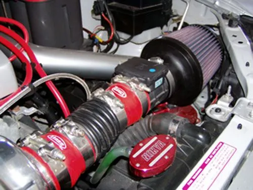

easier said then done!
After the IC and everything should be fine too. Of course, that means you'd have to have a nipple welded into your pipes or something.
Yeah, can't you just run it back to the intercooler piping after the intercooler. Somewhere closer to the throttle body?
^ omg!
think about it....after the intercooler (or anywhere after turbo) there is pressure in the pipes.
u will be blowing compressed air INTO the valve cover if you were to put it anywhere after the turbo!!
(poke)
so i should probably reattach my line to the cover...eh? it seems like that's the concensus, it's what i've been reading also..
what's one more stinkin red hose!

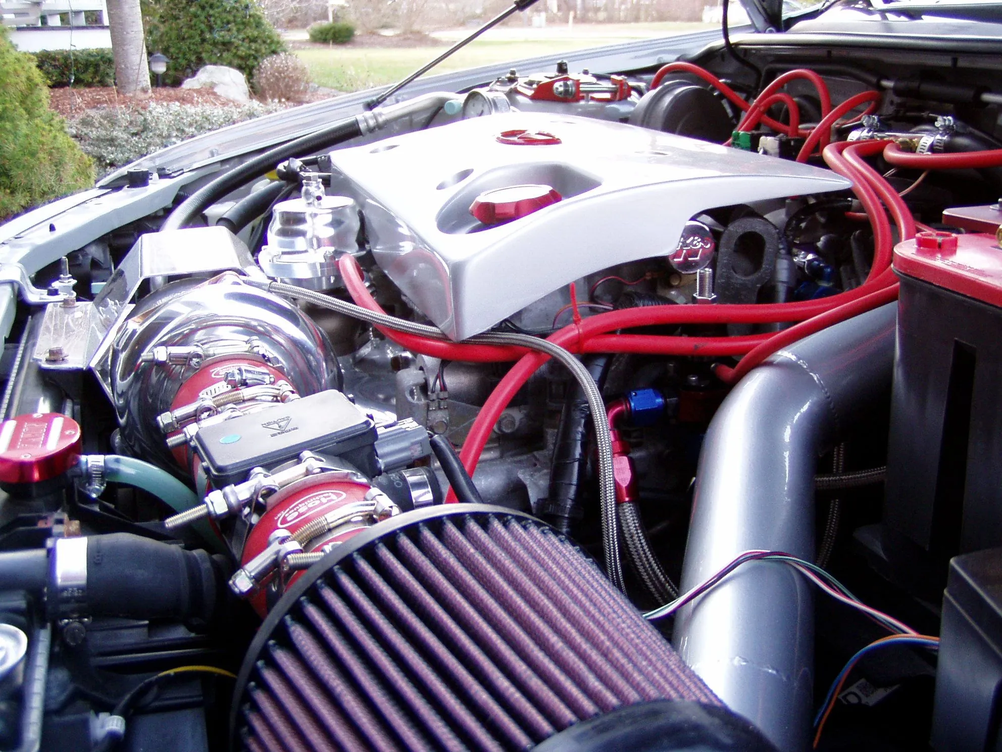

Hey Bazooka, you could replace that flex pipe on your intake with a metal pipe (roughly same length) with a nipple welded on for the hose. That should take care of it and should not cost much $$.
or you can use a rubber gromet/nipple like this:
Oh wow, thanks for pointing out the whole thing about having compressed air.
I'm naturally aspirated as you can probably tell.
Mark, maybe just put that welded short pipe that you didn't like back in place? (shrug)
