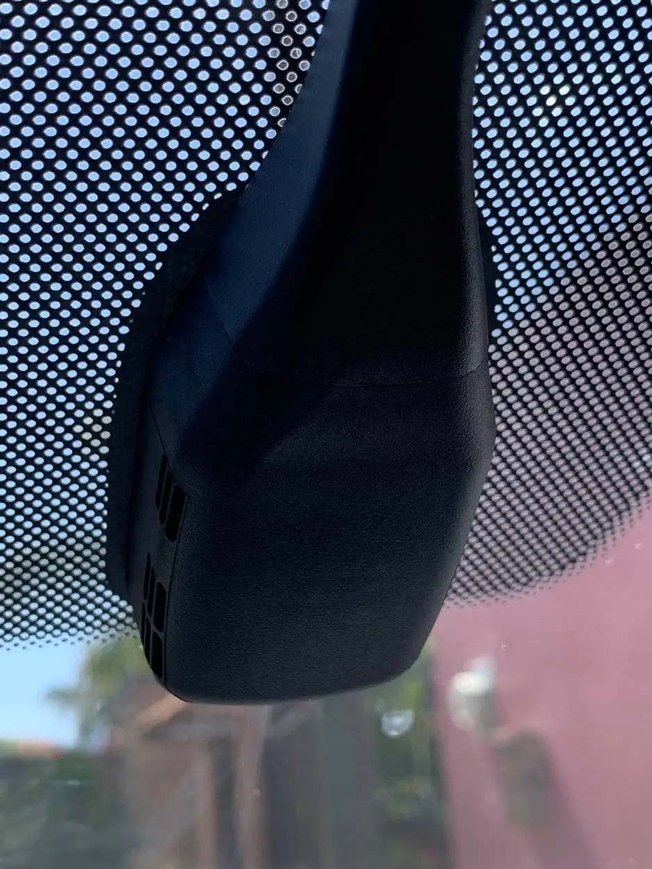

What is this device mounted behind the rear view mirror?
I recently purchased a 2018 CX-5 and found this device mounted behind the rear view mirror. Can anyone tell me what this is and what its function is? Thank you!

Doesnt seem like oem part. The only oem parts/sensors on 2018 are inside the big black plastic box behind the mirror.
May be a gps antenna addon?

In my 2020, that "box" contains the Forward Sensing Camera, though mine is shaped differently and has the standard rearview mirror attached. From the 2020 manual, page 4-122:
"The Forward Sensing Camera (FSC) detects lane indications and recognizes headlights,
taillights and city lights during nighttime driving. In addition, it also detects the vehicle
ahead, pedestrians, or obstructions. The following systems also use the Forward Sensing
Camera (FSC).
 High Beam Control system (HBC)
 Lane-keep Assist System (LAS) & Lane Departure Warning System (LDWS)
 Traffic Sign Recognition System (TSR)
 Mazda Radar Cruise Control with Stop & Go function (MRCC with Stop & Go function)
 Advanced Smart City Brake Support (Advanced SCBS)
 Smart City Brake Support (SCBS)
 Smart Brake Support (SBS)
The Forward Sensing Camera (FSC) is installed at the top of the windshield near the
rearview mirror."
Some 2018 trims have some of those features. If you have any of them that would be your answer.
In the 2020, there is evidently a separate light sensor for the rain sensing wipers and the auto on/off light control. It has two triangular cutouts in the black pixilated windshield film when viewed from outside. I'd guess the large one is for the camera and the small one for the sensor.
If you have none of these features I suppose the box could be a dead man, just a standard part of the windshield with no innards.
