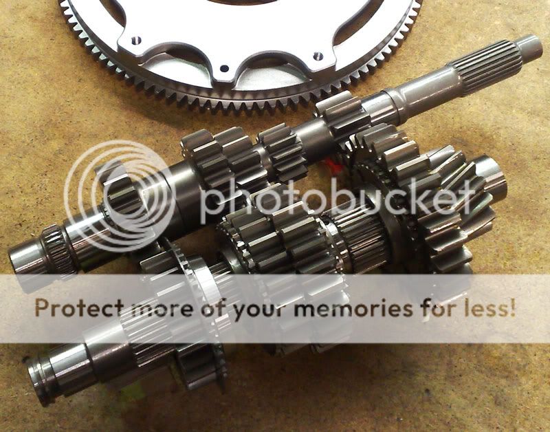

You need gears to hold over 350

What can the stock trans handle? Do I need to make sure that I keep the HP in a certain limit? I guess from what I am reading and you all are saying, the car most have been a good deal. One shop told me that I can install methanol injection, would this be a good idea? Thank you and I will post pics and documentation of the work that has been done.
300 WHP even of you baby it, will eventually fail 3rd gear Synchro.
Eventually you will release the clutch too quickly and it will grind out

So even with an Mfactory LSD and spec stage 3 clutch you wouldn't push more than 275whp??
