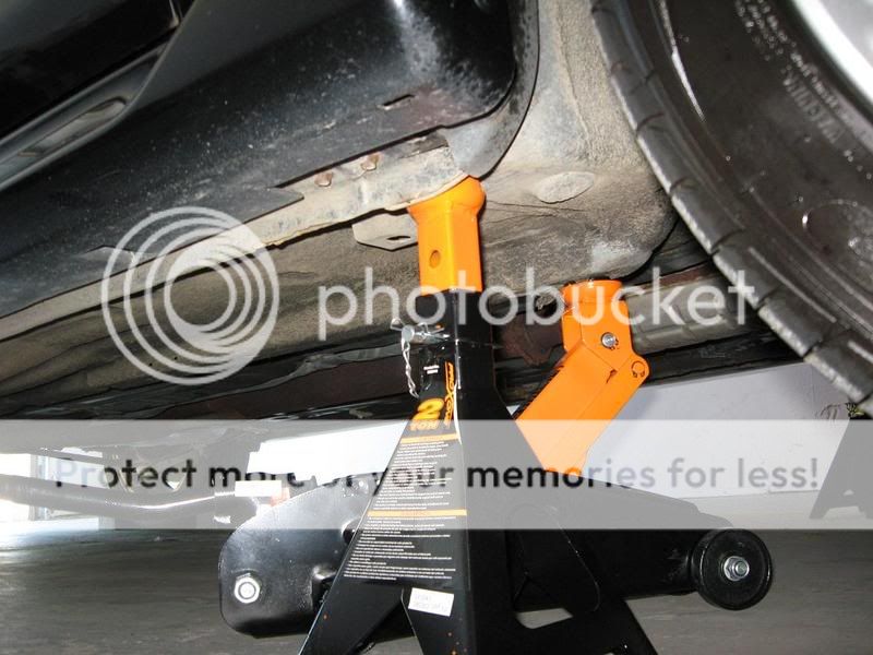

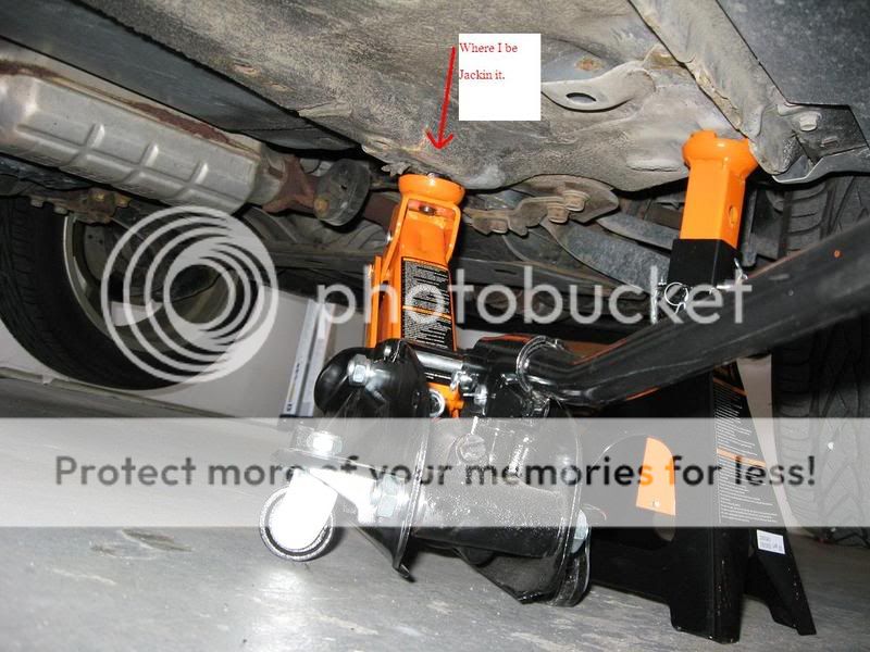

Am I jackin it right?
Sorry for the noob like post here.
I plan on taking off my broken fog and front wheels.
I just bought all of the tools needed and have never jacked my car up before.
Are these the proper spots? The manual was no help and I searched and found some info, but few pics.

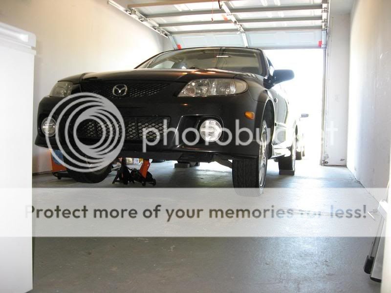

She can fly!
Thanks for the help and comments and laughter that I'm sure will follow.
LOL... Nope those aren't the proper points for the jacks... lower her slowly before you damage your floor board
Theres a little ball looking thing with a hole in the middle in the front behind the bumper close to the center... that's a safe place to jack from the front. from the side you missed it... it right there... you can see it in the last picture right where those two bolts are and a little more to the left... you can tell its a jack point cuz it looks a little indented/damaged. Its the same for the other side.

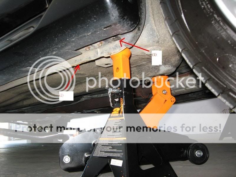

I tried using the ball thing, but that wouldn't get it high enough to get the wheels off the ground. So where do I jack, and where would the stands go then.
Spot 1 is next to the bolts, on the flat area.
Spot 2 is on the rail like area.
(seems too flimsy on the rail area like that, but what do I know.)

the ball thingy in the front is a good jack point in the front
that is a problem not being able to get the car high enough to put the stand under the correct spot 2... you could possible put some ply board under the jack and a block of wood on top of the jack to get it high enough to put both jack stands under the car
Spot 2 is the correct Jack Point
you can jack there and still have enough room to put the stands

So, jack the rail huh.
I searched this dang place and found nothing that simple.
Thanks all... hopefully I won't be so noob anymore.
I've learned from the jacking experts!
