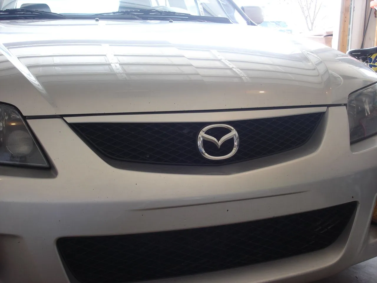

Busy Saturday for me yesterday. Got the new rotors installed, got my new exhaust gaskets form Racing Beat so the exhaust went back on, and did the front grill.
I do have to say, the exhaust without the header isn't too bad at all. That friggin header adds alot of noise..........
