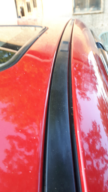

and last thing is a question, how can i take these damn caps off with out breaking them i didnt touch the left side cuz i didnt wanna F***K that side up too .......
https://ibb.co/QDYjydm
https://ibb.co/z2m6cyB
hopefully that doner car is still there to go back for the Tien springs with blue konis
Na those are different take a look at my links its the Delete Caps NOT the actual delete strips that you have to remove the headliner to install
NVM i see what your getting at ...... they old and brittle so im kinda F'd unless i take them basically like the strips
