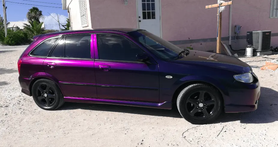

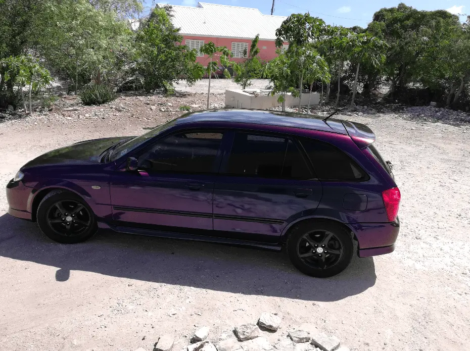

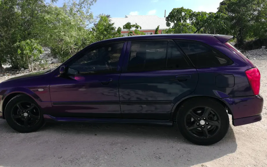

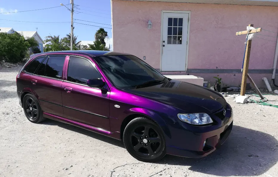

Holy crap that color is amazing!

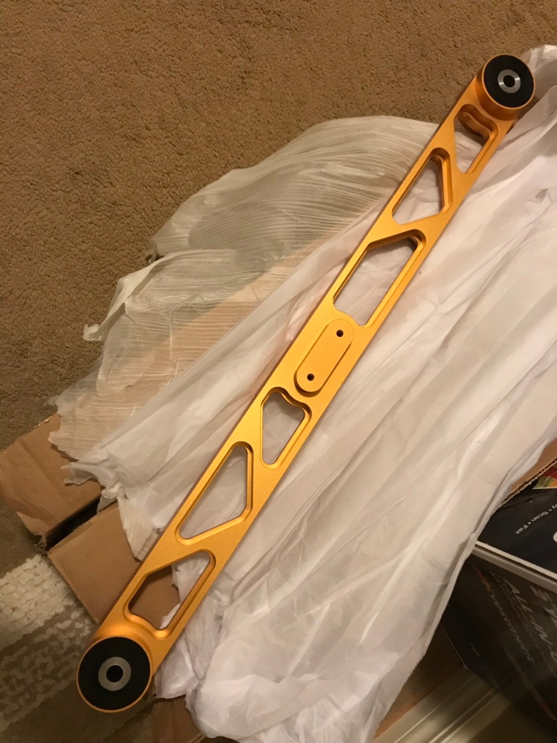

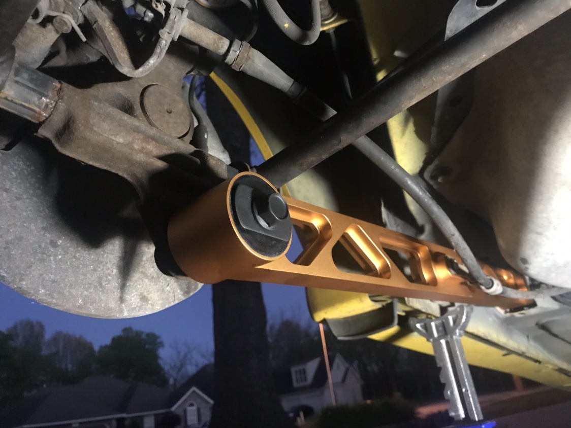

I just put my summer wheels/tires on and installed my Hydra trailing arms. Out with the old, in with the brandnewawesomeshinygoldsexy trailingarms [emoji1787]
hezron - yes that color is really amazing! I usually dont care for wraps as they tend to have more of a flat matte style finish. Yours seems to shine like a gloss paint. Looks really nice.
Protege5 Smoke - Those trailing arms are awesome. I'd love to pick up a set. How do they feel driving around? I have the AWR trailing links, but those Hydra arms look beefier.
Honestly, I cant say theres a huge difference. But I havent really pushed the car since I put them on so theres not really any way of telling. As far as getting some, get a hold of Hydra on FB see if he has any more unclaimed sets. Otherwise, see if someone wants to part with theirs lol. It was a limited group but though, so your chances are slim.. :/
I saw a guy selling the Hydra ones on the Mazda Protege Parts group on facebook, not sure if they're still available or not.
Apparently it looks like he'll only be selling out parts in group buys now rather than 1 or 2 orders at a time and having to produce them every time. Don't quote me on that though, just too lazy to find his comment lol.
I'll keep an eye out. Thank you!
