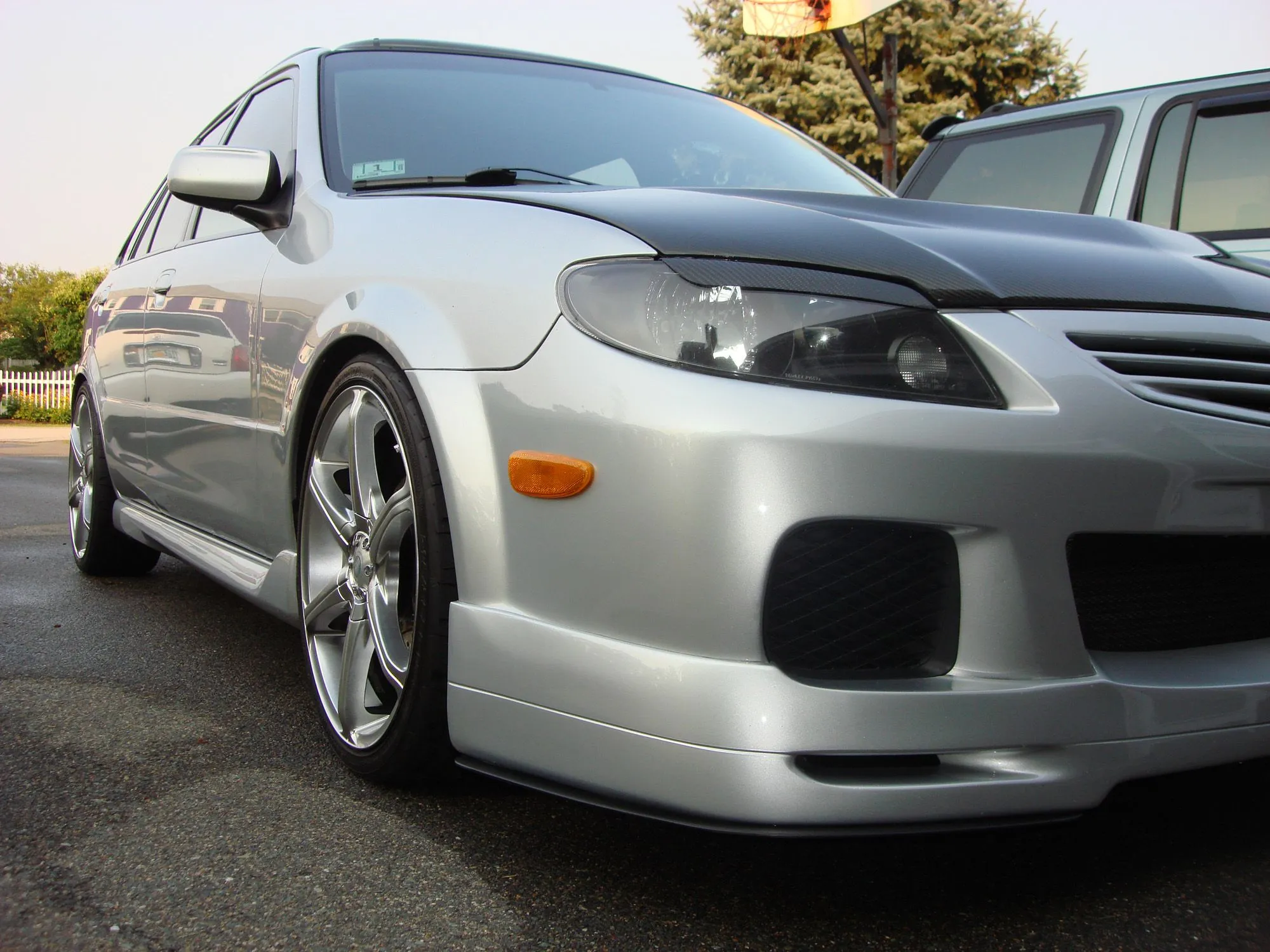

http://img.photobucket.com/albums/v333/viscous/Protege5New001.jpg[/IMG]
http://img.photobucket.com/albums/v333/viscous/Protege5New003.jpg[/IMG]
what kind of rims are those? they look like mine except they have one more spoke
they look really good, those pictures make me want to buy a msp front lip
