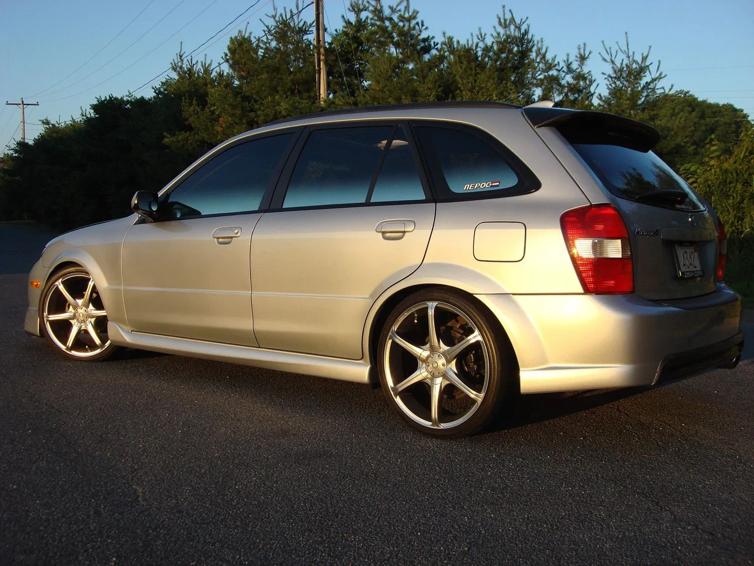

up early for sunrise...intitled "morning glory" ;)
