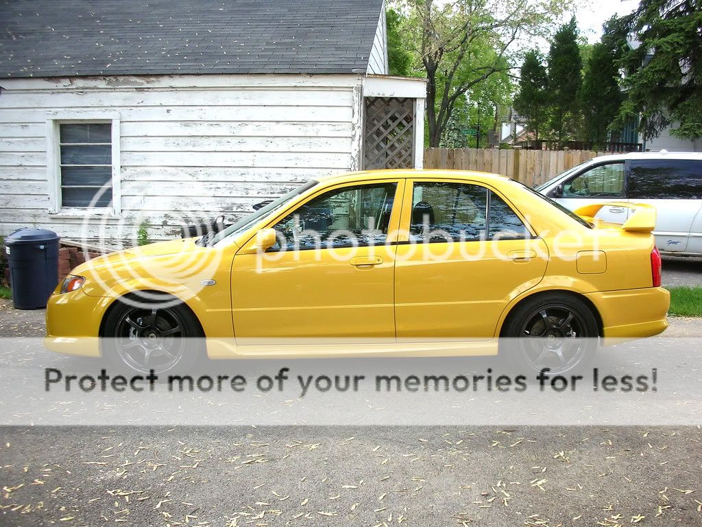

Figured I would finally add to this post! I have a laundry list of things recently done, however the rota boost's and espelir springs are my favorite. washed and waxed figured i'd throw up a pic. Also removed the black tape around the windows.
