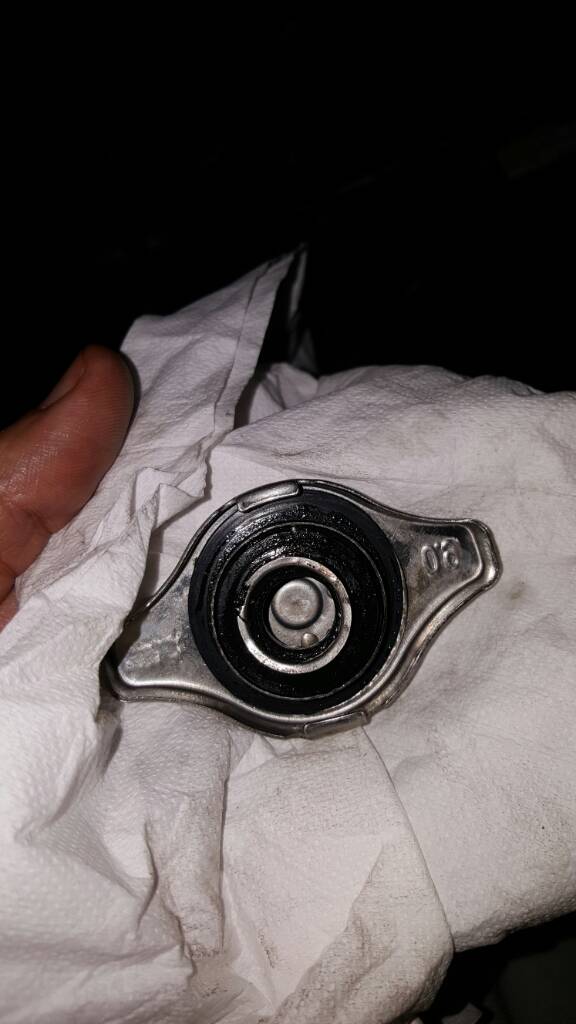

My car just overheated. The water pump and radiator is less than 2 years old. It's not leaking from any of the radiator hoses. What could it be?
Sent from my SM-N920T using Tapatalk
Head gasket isn't the answer you want, but if the cooling system is healthy it needs to be investigated. Is there oil in the coolant or coolant in the oil?
Sent from my HTC One using Tapatalk
I'm not sure. Can I check that with the oil dipstick?
If things are real bad, the oil will look like frothy chocolate milk that can be seen on the dipstick. It takes a lot of water in the oil to do that though.
I just checked it and it seems fine. No frothy chocolate milk
That doesn't guarantee anything, but that's still good news. It's also worth checking the thermostat. Pull it and put in hot water and see if it's behaving itself.
I'm on the side of the road. I don't have hot water accessible. I'm gonna check the coolant level from the radiator cap once it cools down. I'm gonna try to put coolant and water in and see if I can drive it at least to my uncles
Let it cool, throw some water at it, and get it someplace you can diagnose the problem.

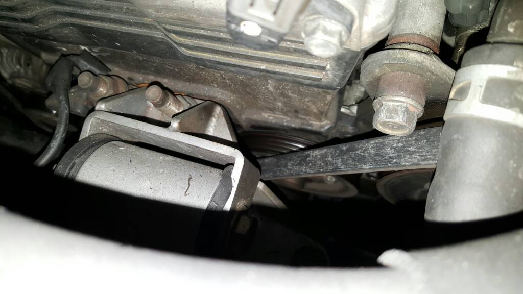

I checked the belts and the belt that goes on the alternator and the water pump is not there. It probably snapped off. Also the radiator cap is broken. Does that equal a blown head Gasket or could it just be the belt and the radiator cap?
The missing belt is your entire problem. Get a belt and you're in the clear. The cap is collateral damage or a coincidence but not the real problem.
