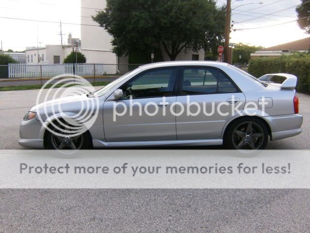

You had super rake because you were running Tein springs on the MSP HP shocks...the higher perch on the rear HPs is what caused that. Since I'll be running Illuminas and S-techs for a regular protege the drop will be more even.
you lookin for that super-rake look?
this is my MSP when i first bought it (w/ tein s-techs)
you should go with eibach pro kit if you can find'em, its a more even drop...
