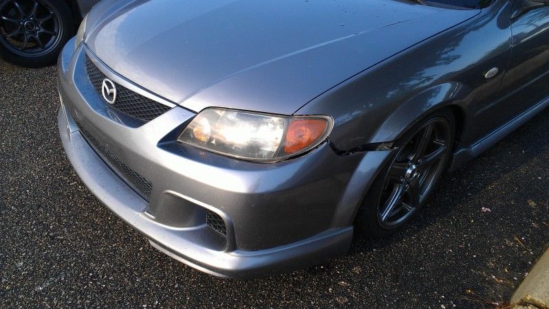

Car tired to eat a curb this morning and lost.
