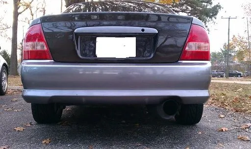

installed my new exhaust last night and took a picture of it this morning. Enjoy =)
