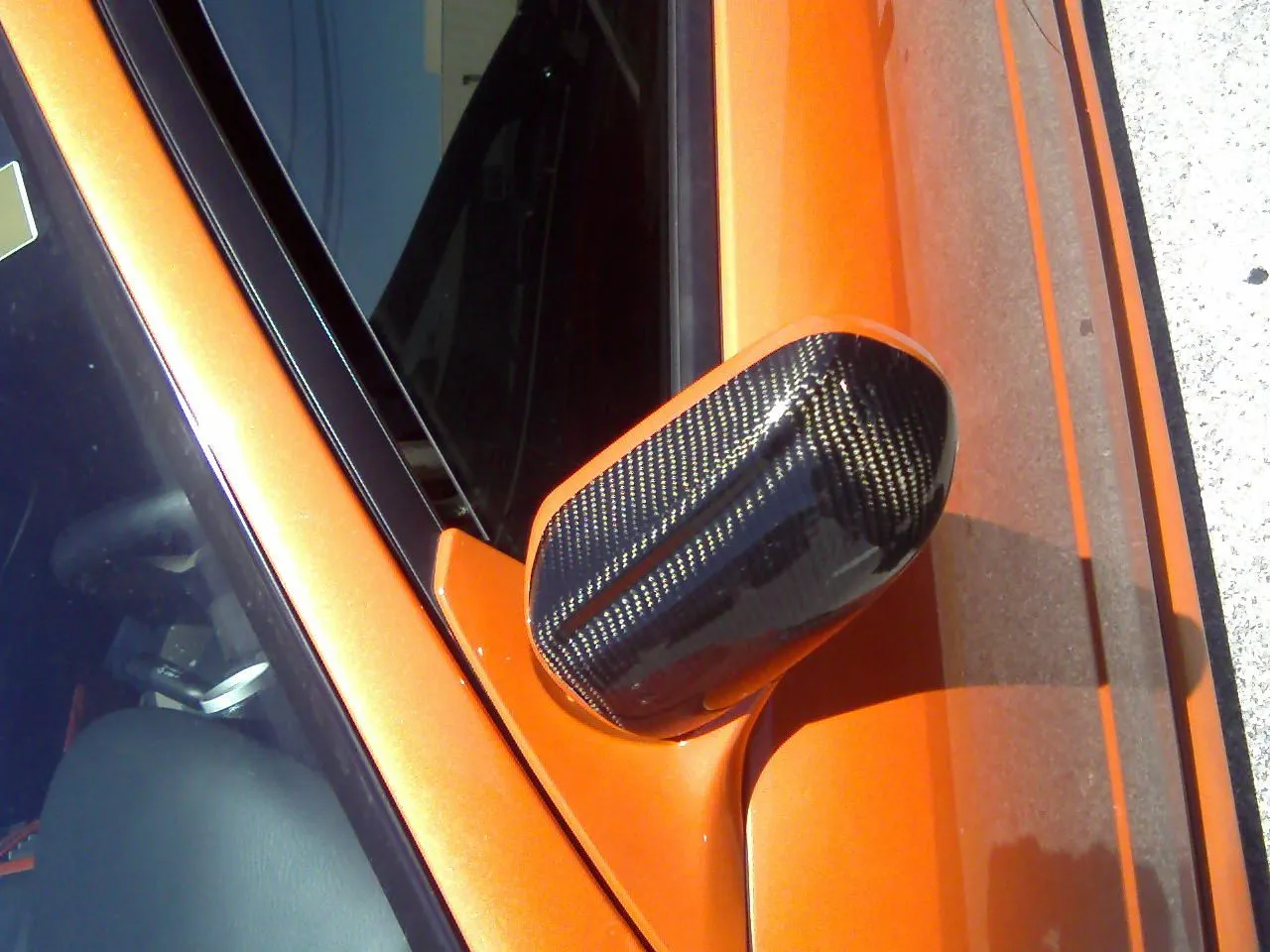

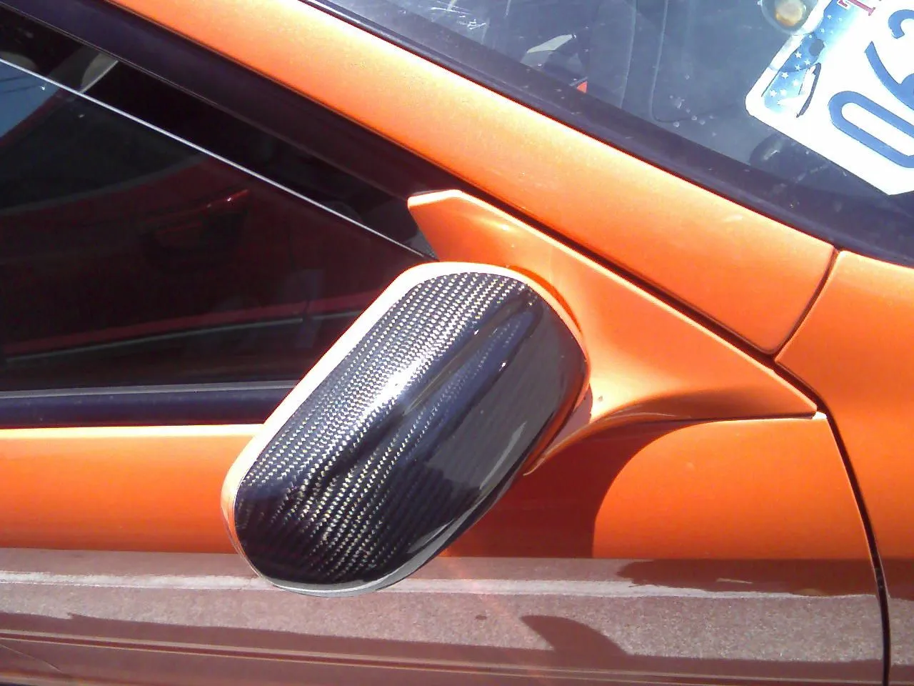

CF mirror covers came in the mail today, thanks Discospeed
