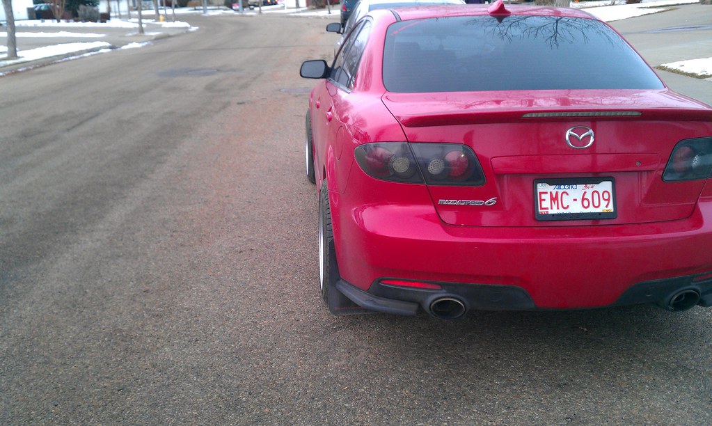

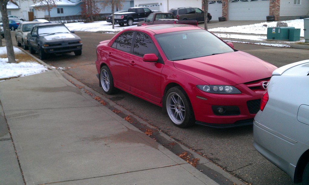

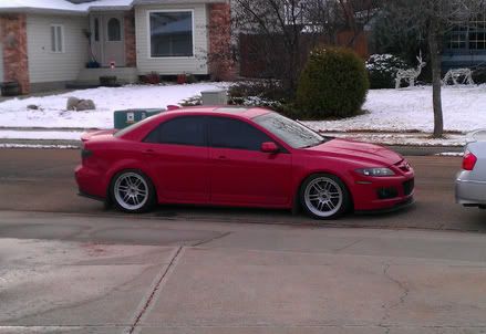

the rims needed to come off, a fender roll in the rear was done, then the winters went back on haha. i was just so excited when they showed up i just had to put them on.
They are 18x9 +35 with a 235/40 tire.
now my h&r springs need to go in, i need to get some spc ball joints and a stiffer set of struts.
Wow that looks sweet! 18x9 too mmmmmmm. Begging for a drop, but you got the h&r springs so you're good.

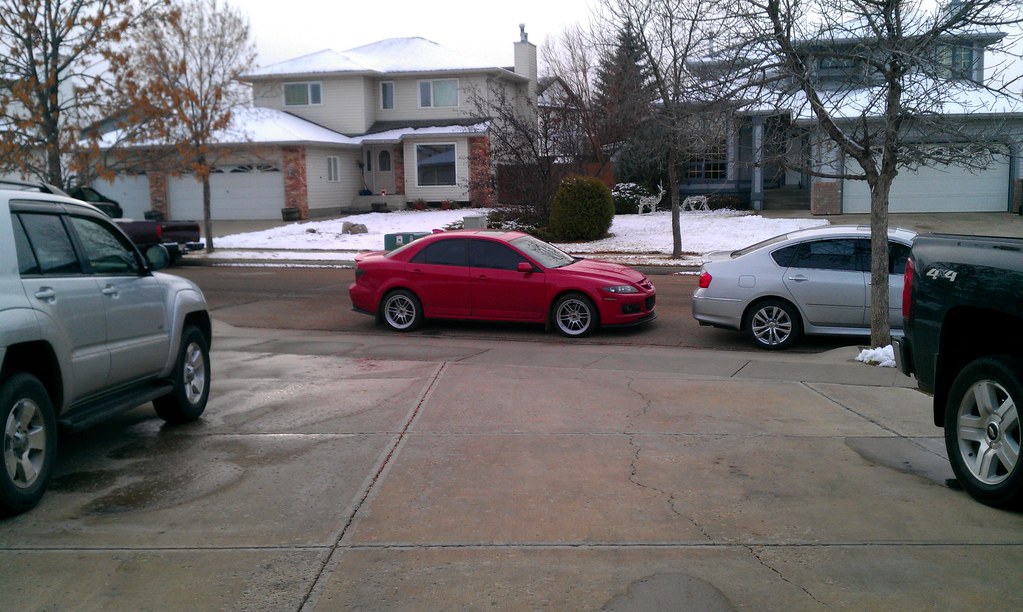

For fun because I was bored:
looks awesome!

Holy Boners, but I'm undecided on springs or selling them and getting coilovers... I'm back in school so funds will be limited till I'm out.
