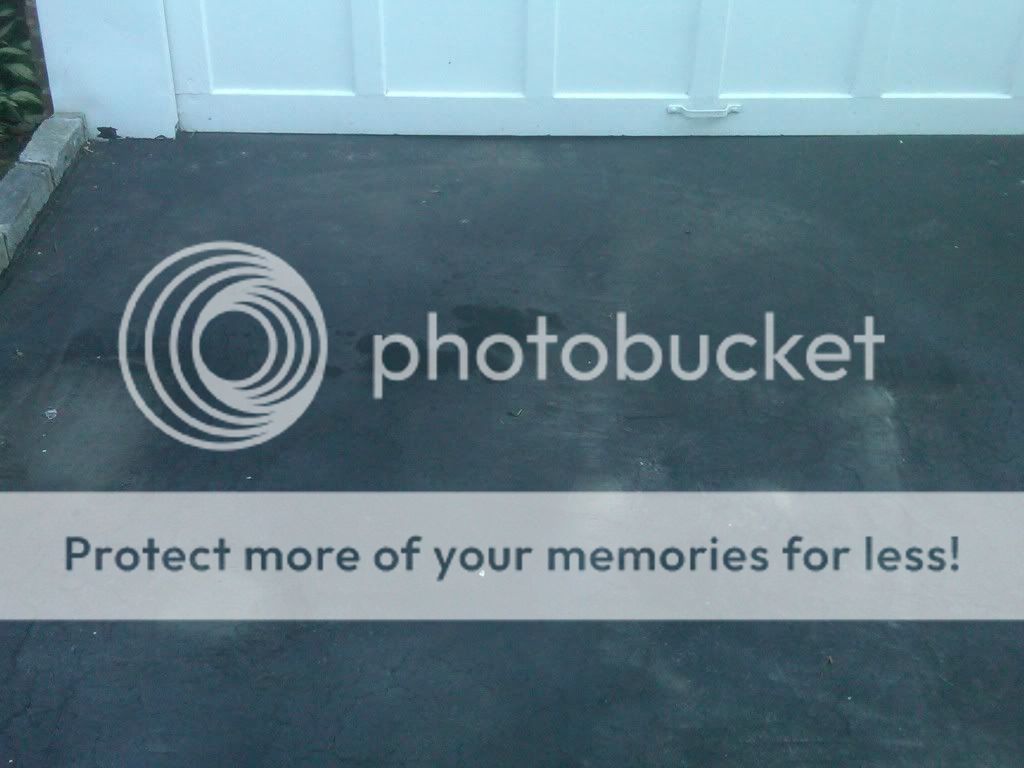

the block is leaking oil, from where i have no clue nor do i care at this point
i dont care as in let the dealer figure it out and if they b**** at me im getting rid of it

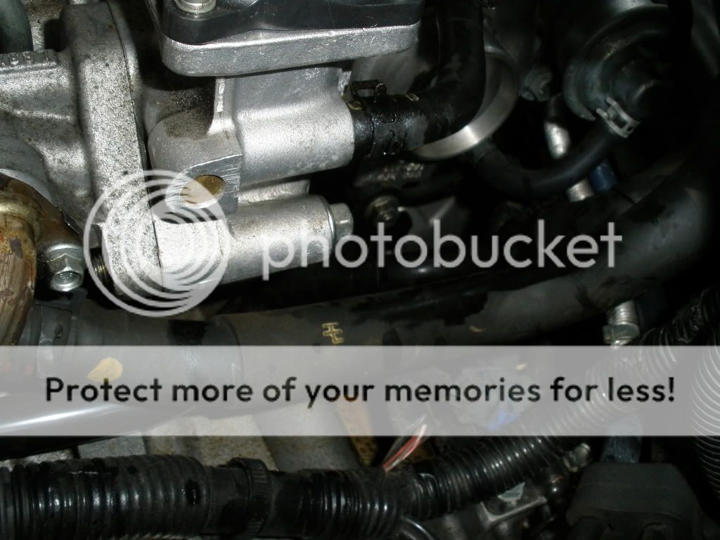

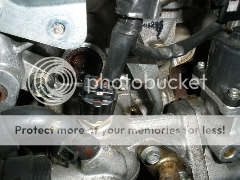

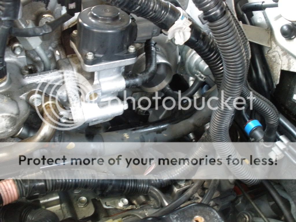

some pics to help illustrate my frustration

Looks more like spatter than leak, like a hose (pcv) was loose and pressure made some oil get blown out on stuff
if you look at the locations of the oil splatter that doesnt make sense
ive got oil UNDER the TIP connection to the turbo
ive got oil under the cdfp
ive got oil on the hotside coupler and turbo itself
misc pooling
if it was the pcv it would be at the front of the block down low
if it was the valvecover breather it wouldnt be able to spray oil where it is (coolant hose, underside of tip)
