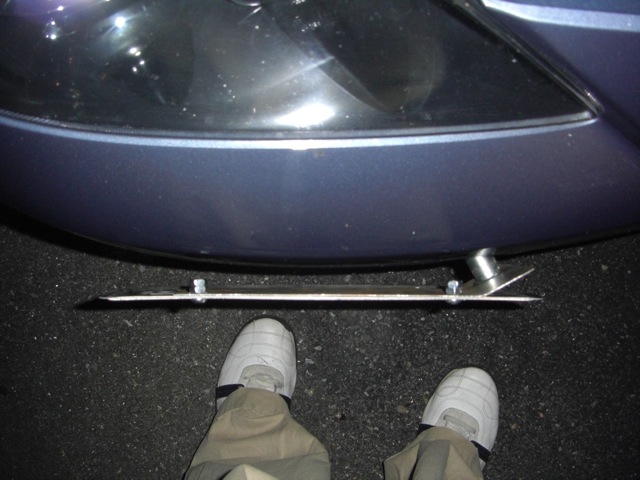

I was just planning on fabricating the already existing tow piece the car comes with. It really has no other use after the initial traveling the car took by way of ship to keep it from moving around.
I cut my tow hook and tapped it for a 1/4-20 screw and bent a piece of sheet metal (.200 thickness I believe) and drilled some holes and done. Now just need to replace the tow hook..
Since those pictures I took it off, cut off that corner that was exposed and painted it flat black so its not as noticeable.
how does that hold up at 150mph?
haha haven't tested it at that speed. I have kept an eye on where the bolt is on the back for the license plate to see if a mark appears. I have taken it to 120mph and it hasn't had a mark or flew off.. You can force it to touch the bumper but it does take some force.
looks good, but why don't you just delete the bolt on the left?
I have thought about getting a rubber stopper or something like that and attaching it to the back just in case it does touch the bumper it will be stopped by the piece of rubber.
Totally stealing your idea.....haha
Sport6 -- nice stuff, I'd replace the two plain nuts on each bolt with either a lock nut or an acorn nut. You could even get an all-nylon acorn nut so that it won't scratch up your paint. Check out mcmaster.com (rockon)
