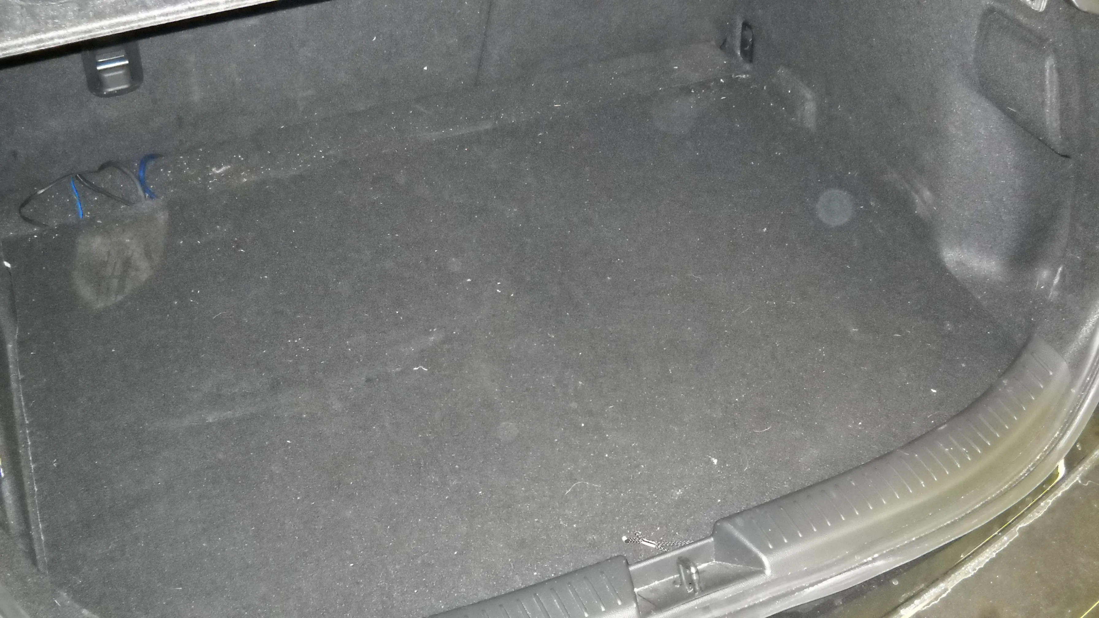

Ok, let the laughter ensue, but today I installed an old Blose Acoustimass sub in my spare tire well. Believe it or not, it is super light, handles 200/channel, fits, and sounds great! Now it doesn't perform like my Hifonics Olympus 15" but it weighs about 100lbs less! It hides away completely and honestly reproduces respectable bass. I still have to hide the wires and vacuum but you get the point :)
I like it! Stealth bass FTW.
