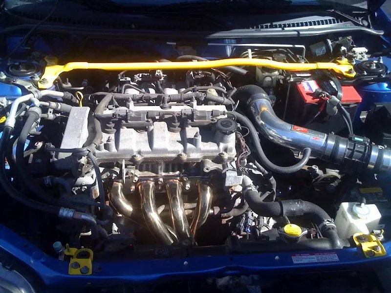

Broken Header pipe.
Well i was in a tunnel and downshifted, and as soon as i hit the gas i heard a horrible sound coming from my car. It seems as though i broke my muffler. so i got her home and jacked it up to see the damage. (breakn) lucky me it was not the whole exhaust but just the J pipe, or header pipe. I am working on going turbo but i went ahead and just bought some headers to put on for the fix until i was ready for the turbo. 100 bucks and two hours and this bad boy was on. (nana)
