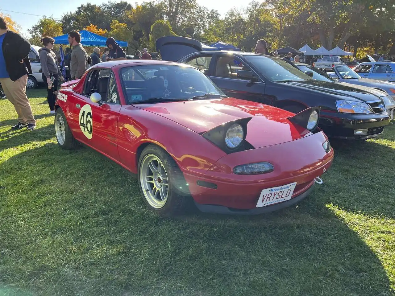

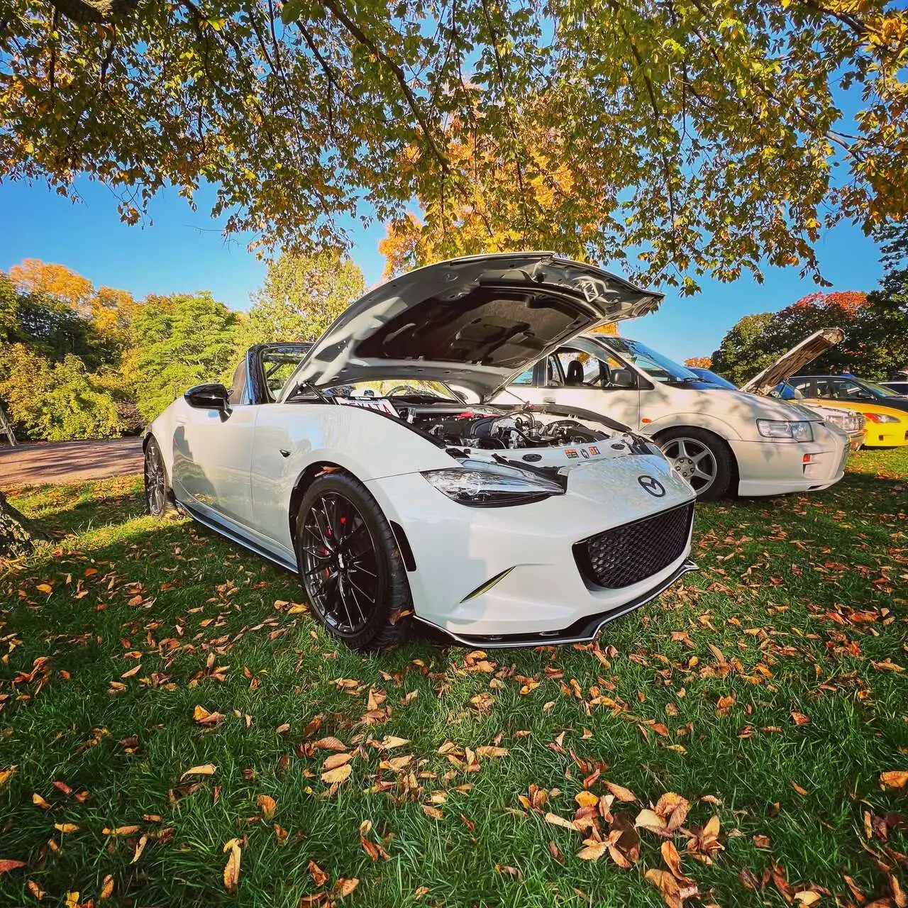

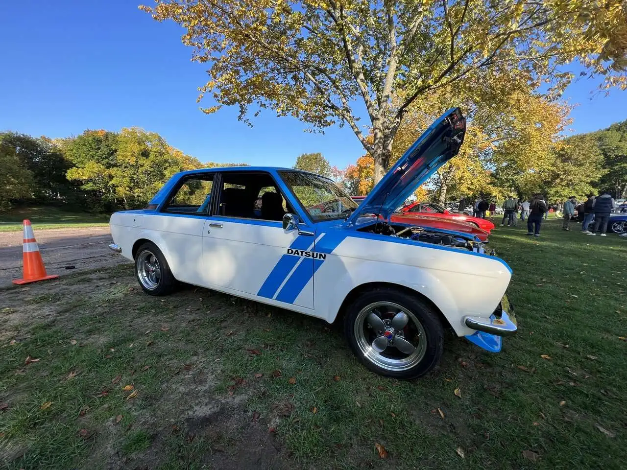

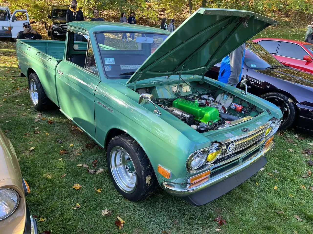

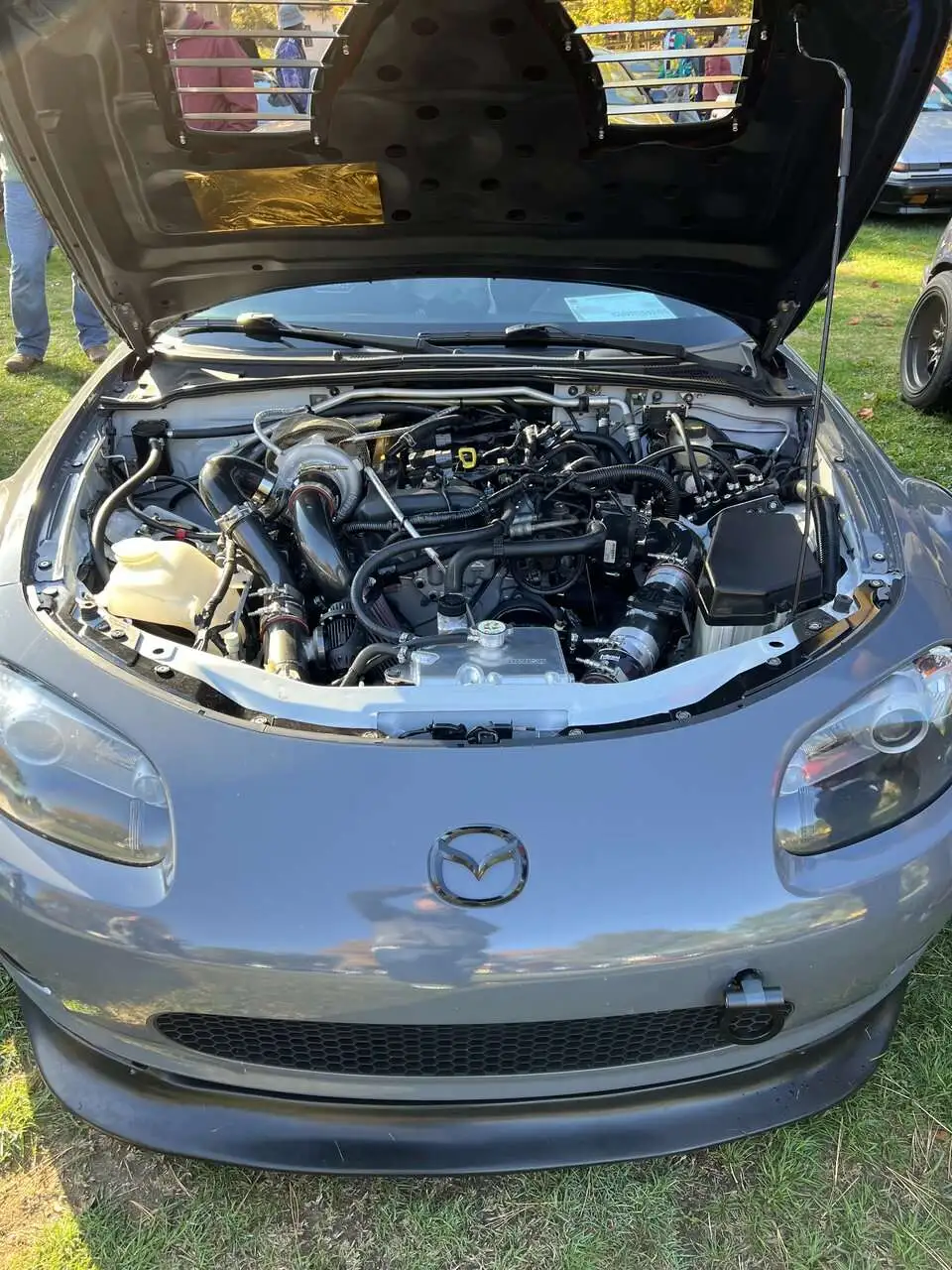

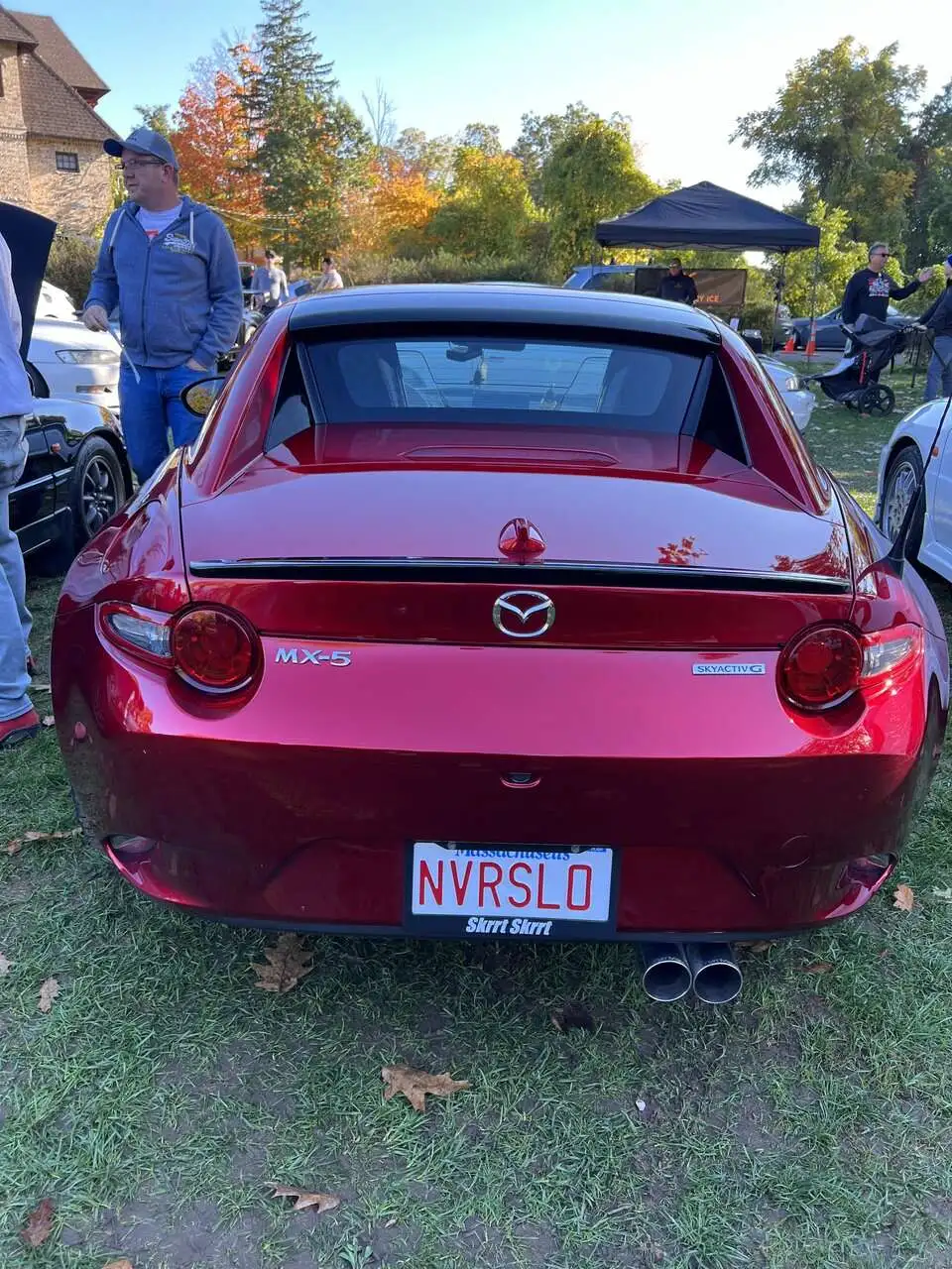

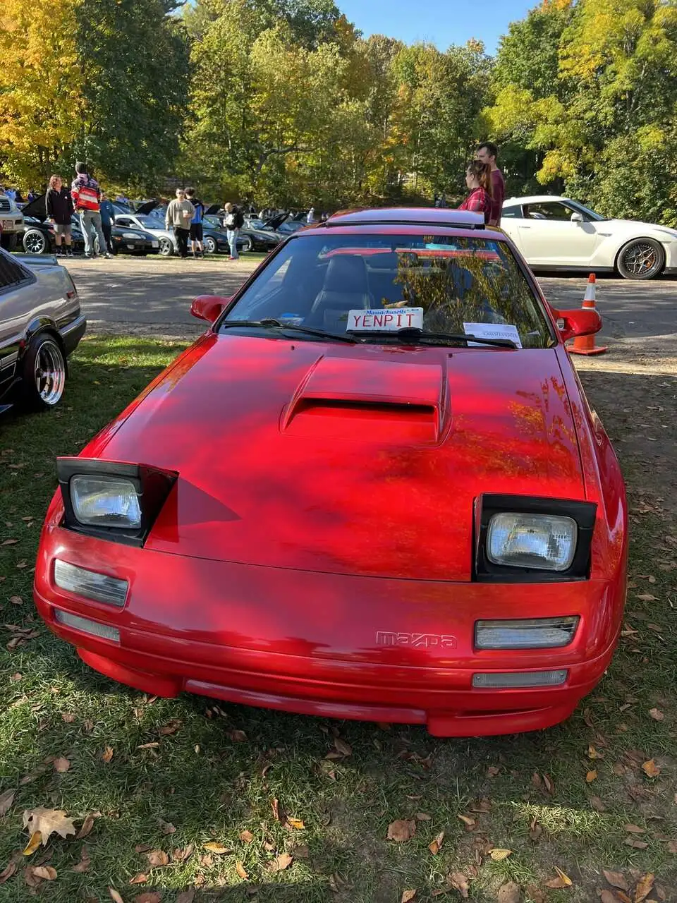

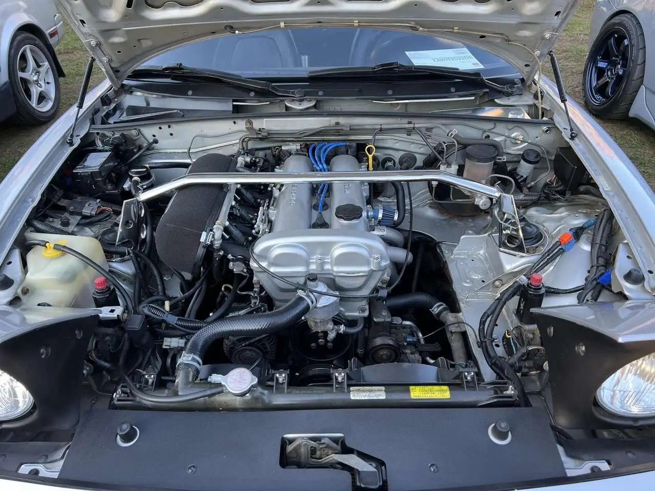

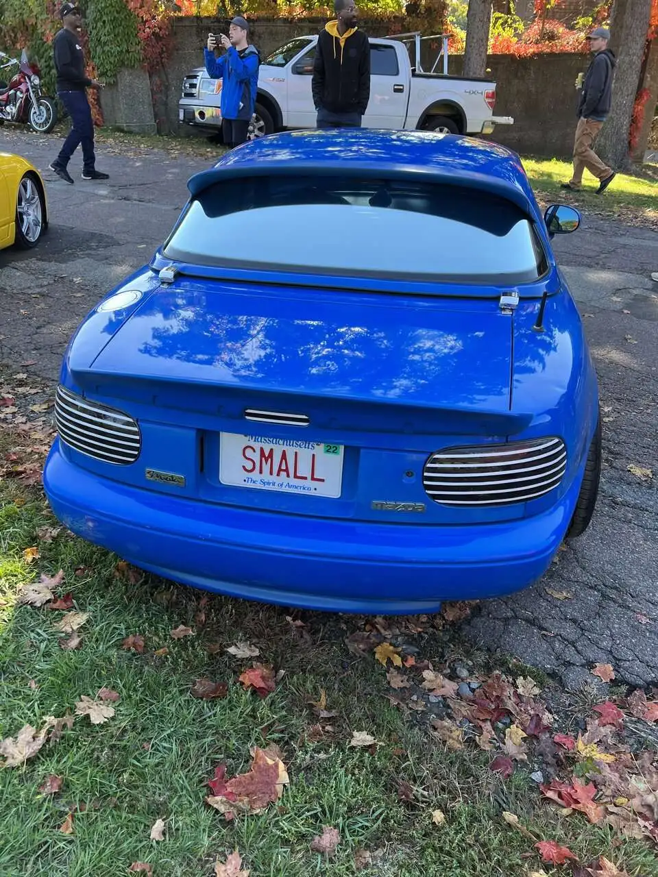

Took her to Larz Anderson car museum’s Japanese Day. Hundreds of beautiful land of the rising sun vehicles! A beautiful days well!
