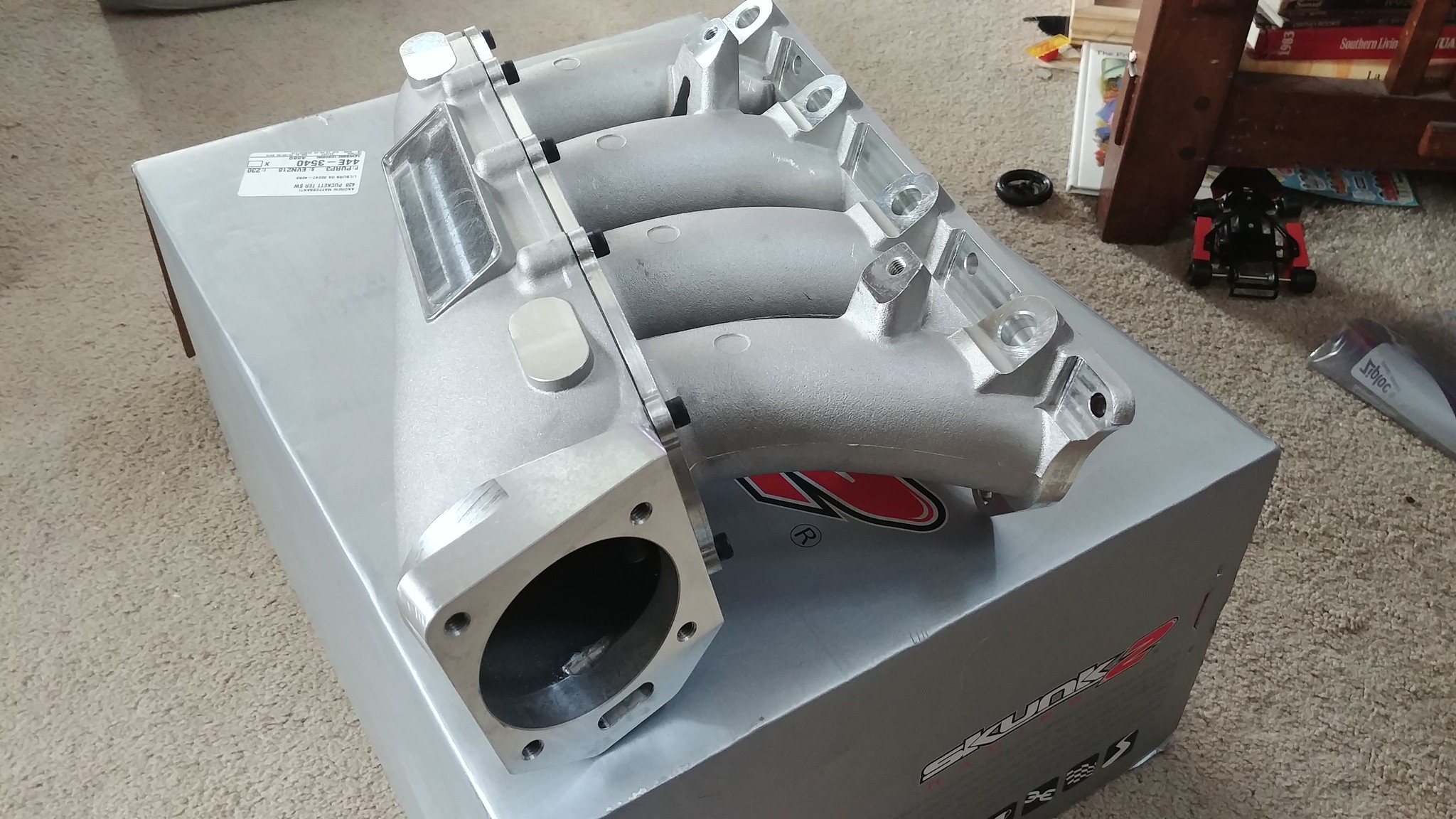

The most important part of my next project has arrived (rlaugh)

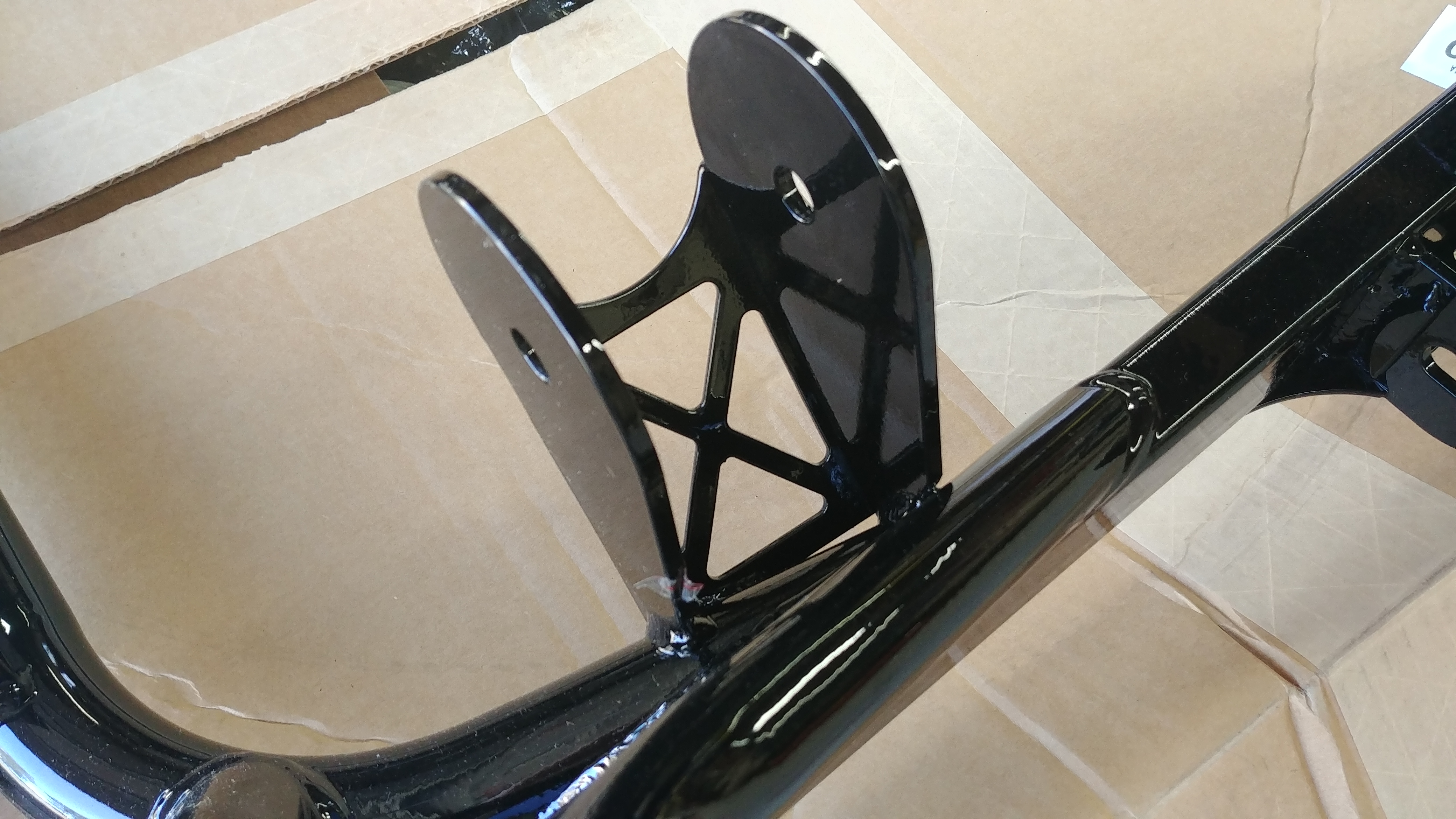

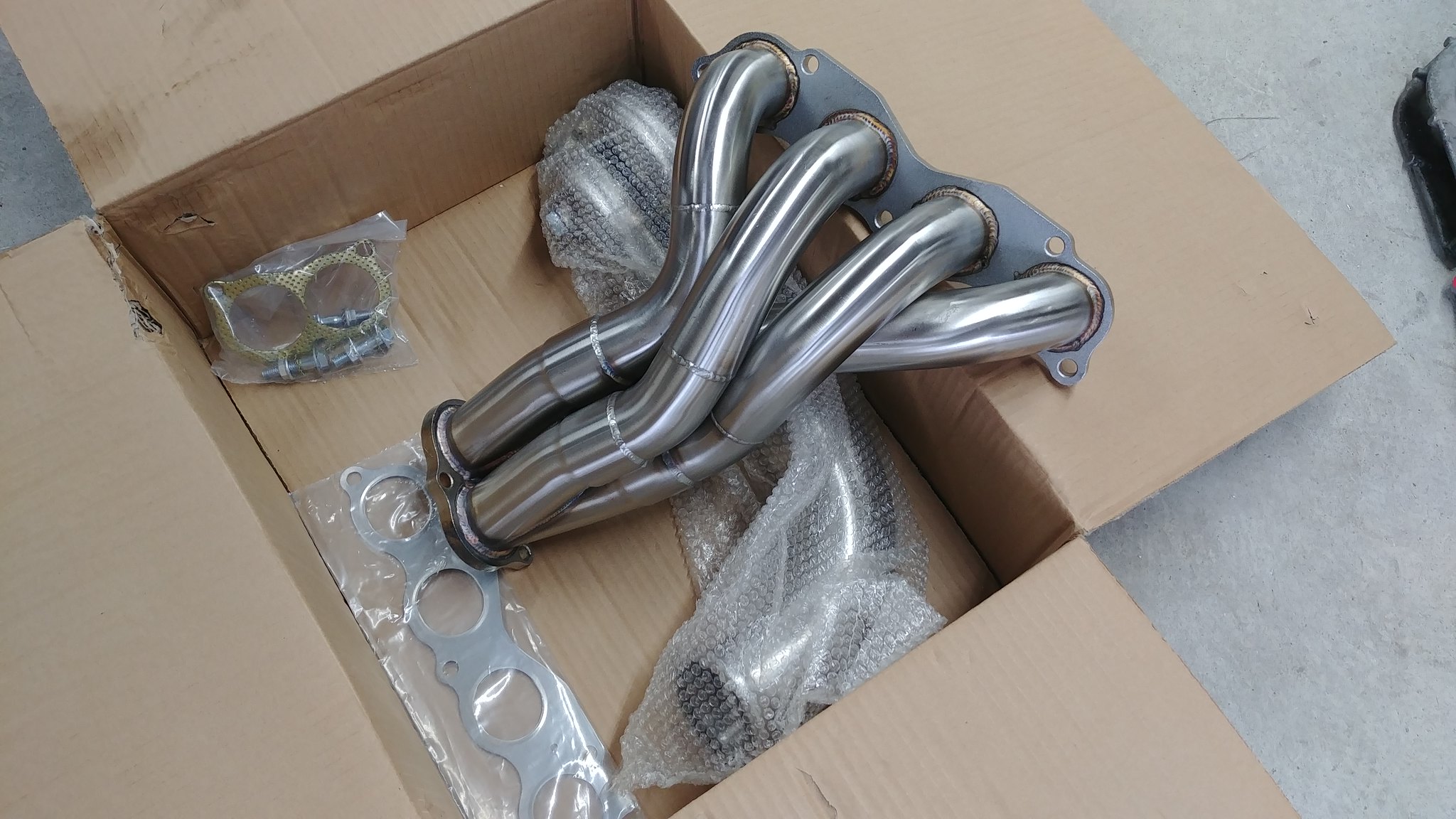

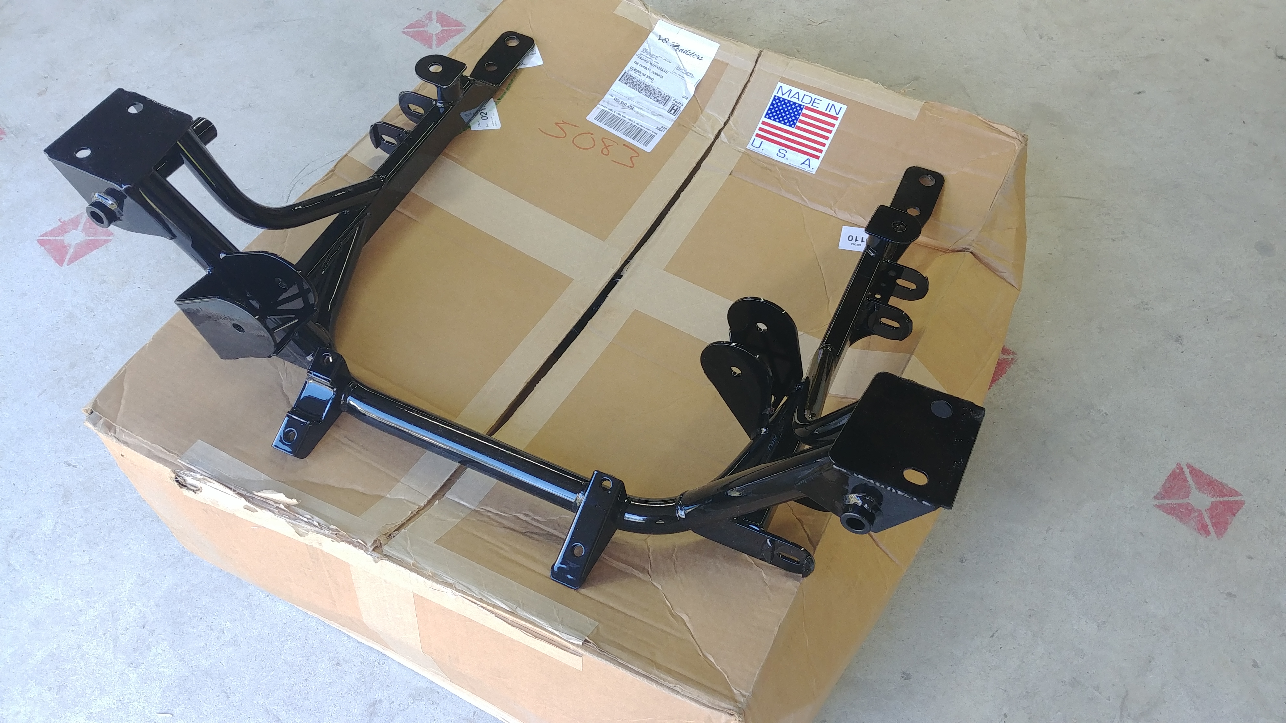

Also this week, I kinda have the 'bookends' for the new motor in.
