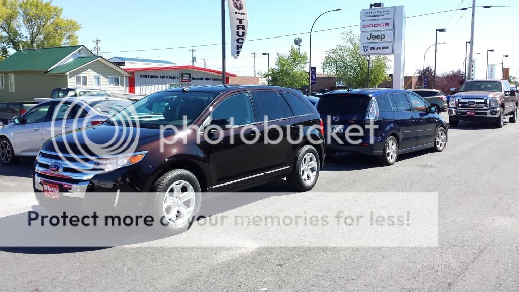

Finally got off my ass to download the last pic of my 5. She will be missed. The kids still ask about her.
Funny how the wheels look so similar. I loved those wheels so they are perfect on the Edge as well.
Nice Edge and very nice color choice. Congrats!
