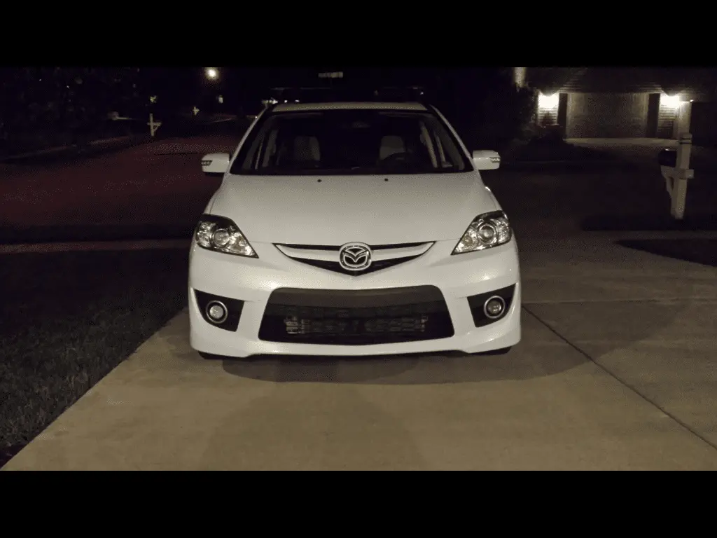

Cracked my fogs a while ago; considered getting projector fogs but I wasn't sure if it was gonna fit the OEM housing.
iJDMTOY http://store.ijdmtoy.com/Mini-HID-Bi-Xenon-Retrofit-Projector-Fog-Lamps-p/70-126.htm
Fitment is good only complaints are bulb seal area could be better and there isn't any mounting threads cut in the plastic so you need to either use self tapping screws or apply a lot of force to stock bolts to cut threads for you...pretty much drop in though and a big improvement over stock housing..usable light now...here's a shot from front

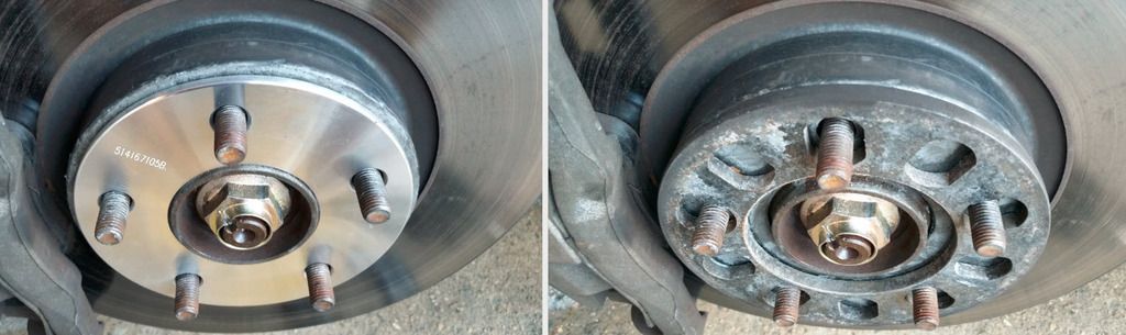

Finally decided to spend $10 to by better wheel spacers (better design, not necessarily quality) to see if it helps with a slight vibration at HWY speed. When I first did the MS3 calipers way back, I was not expecting to need spacers to clear stock wheels. I had to scramble for some universal junk from Pep Boys to get back on the road. I’ve kept using them since b/c I have them and they didn’t seem to cause any problems physically with clearance. UNTIL, I put in 5mm hub centric spacers and it matters.
Anecdotal feedback:
-I’ve run 5/16” (~8mm) thick spacers for over 20K (collectively over 2 cars) and wheels did not come loose or fall off (Do at own risk!)
-I highly do not recommend universal bolt pattern spacers. Even with the best effort to centrally position them (b/c they are not hub centric and bolt holes are oversized) you will get a slight wheel vibration.
-8mm gives a VERY nice flush look :D and possible better stability (+ alignment) as the front track is wider than the rear (assuming stock front and rear are equal).
-8mm spacer will lose hub centric rim mounting resulting in lug centric where proper rim alignment and lug torque is critical, this is never preferred. The 5mm leave a little bit of hub bore but not sure if it really aligns the rim. I wonder if the 3mm might be the best of both worlds!?.. hmmm.. this could be the best compromise for future MS3 caliper converts who are too cheap (frugal/resourceful) to buy proper rims . Not as much caliper to rim clearance as the 5mm but tradeoff is more hub bore to keep hub centric rim fitment (hopeful the shiny new rims are hub centric).
-8mm + my drop shows very faint signs of tire rub (negligible and not a cause from concern but a lower drop may need more camber or fender roll).
